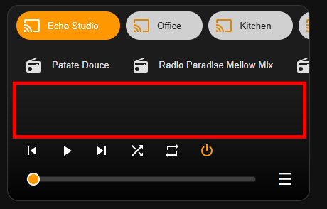

Would this be possible to have a property to specify a url to an artwork when none is received from a script? (instead of having a blank area in the player)
Thanks !
Example:
actions:
  - name: Patate Douce
    icon: mdi:radio
    service: script.media_play_patate_douce_radiobrowser_yamp
    script_variable: true
    artwork: https://cdn.prod.website-files.com/5e57c92306e4fe1dcb7344ef/5f88146fa06b496fccb99f02_LaPatateDouceLogo.png
I might have an alternative solution for you. Can you send me your alexa entity state attributes when this station is playing from dev tools?

We see there’s an entity_picture that represents the logo of the station. Interesting!
(asking my Office Echo Dot 4) “Alexa, joue la Patate Douce” => it actually triggers a routine on Alexa which launches the actual command “Alexa, tell radio browser number 20” (based on the Radio Browser skill)
In this case, State becomes paused and the attributes do NOT change because Home Assistant is NOT aware of what’s actually going on :neutral_face:
The same behavior happens if I launch the Patate Douce radio from YAMP with my
metioned earlier in this thread.
The fact that I go through Radio Browser instead of a direct call to TuneIn seems to lose HA with the state/attributes of the media_player (including no updated entity_picture) :confused:
So it doesn’t seem to be an option to retrieve the artwork in this specific case of mine.

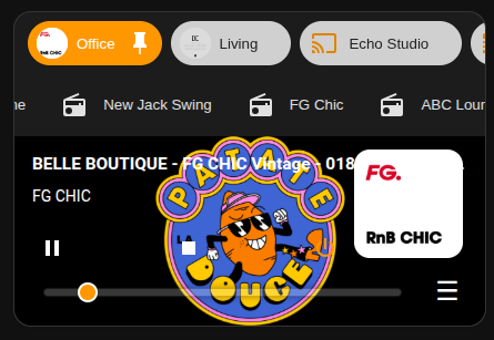

so here’s my proposal (which is kinda janky but there’s not much to go off of). In your script call from YAMP, include a boolean helper that says when the station is on. then use card-mod to update the background of the card to your radio station image url while the boolean is true. just might work, sort of…
something like
card_mod:
  style: |
    {% if is_state('input_boolean.patate', 'on') %}
    .card-lower-content.collapsed.transitioning {
      background-image: url('https://cdn.prod.website-files.com/5e57c92306e4fe1dcb7344ef/5f88146fa06b496fccb99f02_LaPatateDouceLogo.png') !important;
      background-size: contain !important;
      background-position: center !important;
      background-repeat: no-repeat !important;
      background-color: black !important;
    {% endif %}
It almost worked although I have to find a way to set the boolean helper back to off once I select a different radio from La Patate Douce otherwise I end up with its logo overlapping the next radio’s logo :stuck_out_tongue:
Unless I create a script for every station to be able to reset the helper which is doable but a bit convulated…

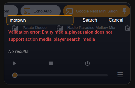

I have updated to v21.0.1 but I must have missed something with the new Search feature :thinking:
When you say “For us Music Assistant lovers” and “for compatible players”, can you elaborate those 2 points please?
Because I get this error:
Sure!
This feature is specific to players created by the Music Assistant add on. When you get your players and music services set up in Music Assistant, the add on creates a duplicate player entity that has Music Assistant specific features, like Search.
You would then replace the entity in YAMP with the Music Assistant version of it (it will likely be something like media_player.salon_2.
Now when you initiate a search on that entity it will return search results from Music Assistant that you can play directly from the card.
Hope that helps!
ps. you’ll need both the add-on and the integration installed. The integration is the one that will be creating the music assistant entities for you
Thank you, it’s working!
I had 2 instances of my Google Nest Mini and I had added the wrong one.
I picked up the other one that was actually the one set up in Music Assistant and boom, the Search came up with results in YAMP :+1:
Too bad this doesn’t work with Echo speakers but that’s a well-known Amazon limitation within HA.
