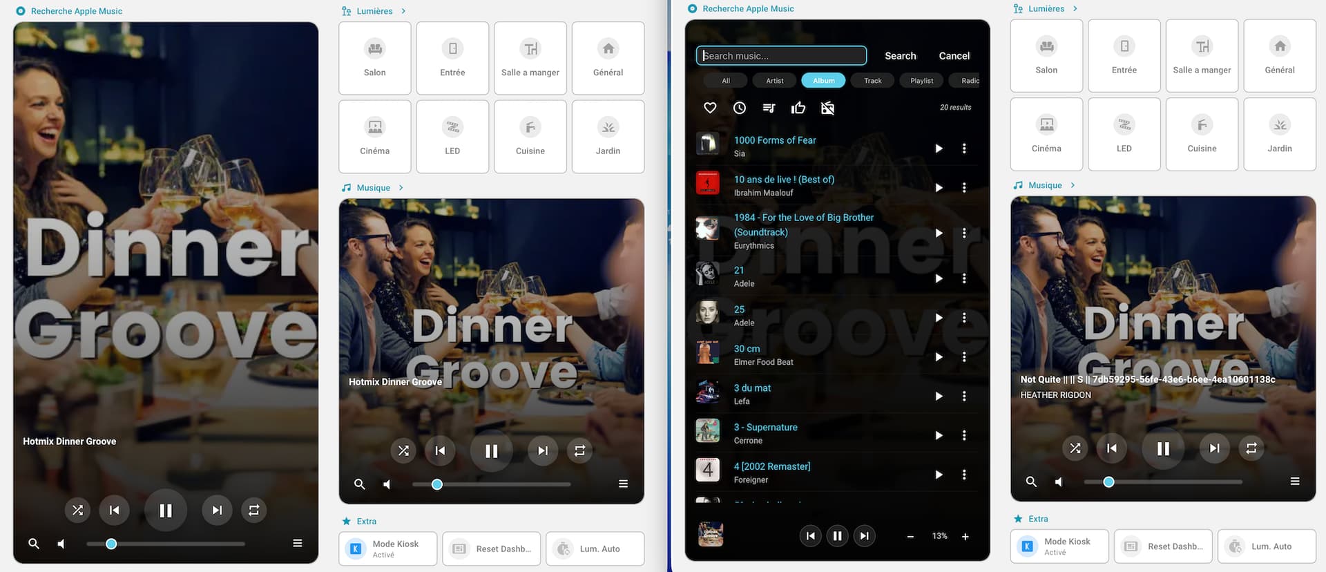

Hi , Thanks for this great card ! I have 2 questions about it .
1/ when I start the player on the right column , I change the visibility of the first column to display the same card YAMP for 1 minute ( bigger to be able to do a search ) . I always would like to see the search option on that card but sometime I 'm seeing the player again ( see snapshot ) . Is there an option to ensure I 'm always with the search option ?
2/Is there a way to follow night and day theme . I 'm my snapshot I 'm on day theme and and I would like the search card to match my theme ( typically no background , be able to change the black overlay(??) from search option and if so, be able to have text and icon follow the theme color .

Thanks for your response!
  1. This is something I have been putting the bones in place for a while now (e.g.: adding idle_screen: search) but it’s not quite there yet. It has been my intention to allow this multi-card functionality though! Since there’s some interest in this it should be the motiviation I need so stay tuned!
  2. This isn’t something I’ve considered before but I can totally see the use-case for it. I’ll add it to my to-do!
@tictac3535 I have created a couple issues for you on github so I can keep track of these. Thanks for your response and happy listening

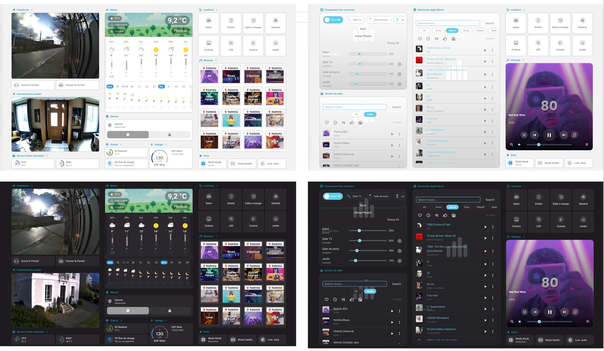

Thanks Jianyu-li for V35 update . It looks great .
Here is my dashboard . On the right , on music section ( I 'm using a sonos card showing up my favorite radios to start the player , I can’t achieve that vue with YAMP) .
So when player start , that card is switched to YAMP (until payer is paused) , and the 2 first columns (based on visibility for 1 minute) are displaying YAMP search cards : Album apple music , another one with favorite radio , and last one for grouping ( not yet standalone card).
I noticed a bug for standalone search card that is still showing the media_title in the background and the YAMP logo ( I selected no artwork) .Perhaps as well you are hardcoding the ha-card-border-radius ( not the same on your card than other cards)
Another improvement could also be another Card view on the search card , that only show the artwork ( no text below ) and start playing on tap.
The cards now follow night and day theme.
That’s looking great! Thanks for pointing out the media title issue, I’ll get that fixed. As far as the radio view, is that because it’s specific to sonos ? default_search_filter: radio will default to radio stations in music assistant. I can look into sonos specific features
