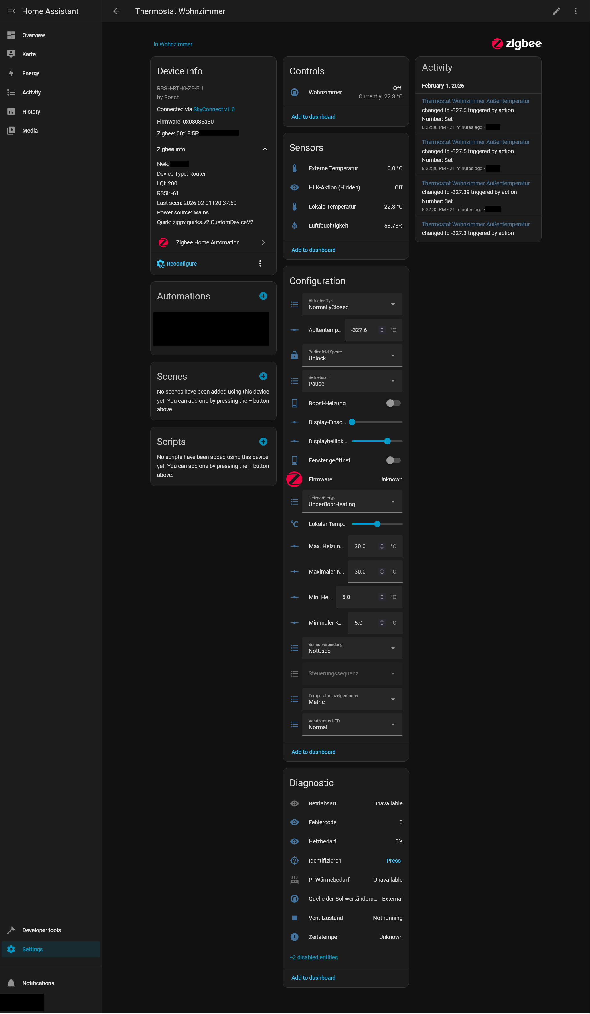

The thermostats are connected via Zigbee and integrated into Home Assistant. I’m not using a Bosch Smarthome Controller because I wanted a local-only setup. In Home Assistant, all thermostats are disabled (turned off, not entity disabled), yet it still feels like the heating is running anyway.
The Zigbee integration exposes a lot of configuration options that I honestly don’t fully understand, like actuator type, heating type, sensor connectivity, etc. When I try changing some of them, things break. For example, if I change the heating type from “UnderfloorHeating” to “CentralHeating” (which is what I actually have, with a heat pump), I get an error saying:
“Failed to perform the action select/select_option. ‘uint8_t’ object is not iterable".
Recently there was an update to the Zigbee integration, and it feels like these issues started around that time, but I’m not 100% sure. The update added even more options, like cooling, which I don’t think my apartment even supports.
I’m struggling to find proper documentation for this specific Bosch thermostat with Zigbee in Home Assistant. I don’t really know which settings are correct, which ones matter, or how they’re supposed to be configured. On top of that, I don’t know how to reliably check whether my heating is actually running or not.

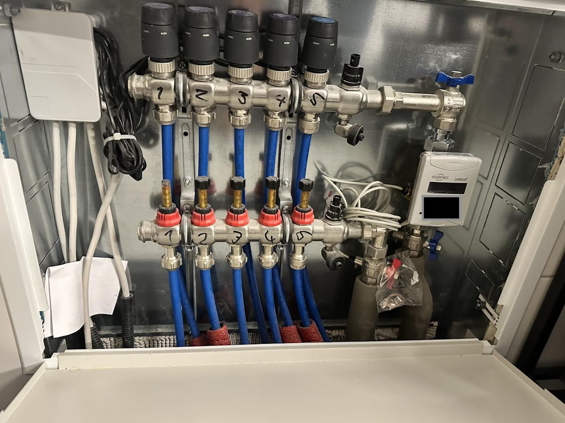

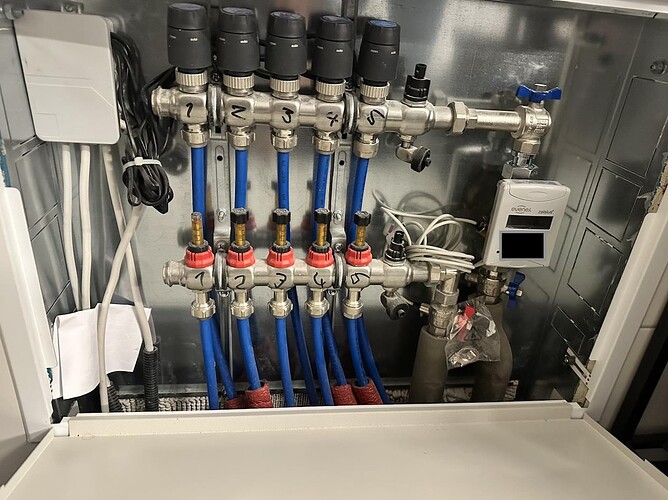

It is a central heating system, so no boilers or radiators. There is a water pump for the building that all 4 flats share. I have some controls for the heating in my bathroom, as seen in this picture:
I wonder what (if) there is any effect from the -327° outside temperature…`
This value was set automatically when adding the integration. I think it can be used in automations to adjust heating based on the outside temperature. The Bosch thermostats support adding an external sensor. If I change the value to something reasonable it shows up on the thermostat, but nothing else happens from my point of view.

Back to your initial question: do you have perhaps configured an offset for the temperature? in your screenshot there is one entry where I can’t fully read the label, a slider with the label “Lokaler Temp…”
the thermostats allow to configure an offset to adjust the measurement taken directly at the thermostat

The diagram you’ve provided shows a control system for floor underheating, not radiators.
You have two independed heating systems.
If one turns off, that doesn’t guarantee a temperature reduction, as the second system could (possibly) compensate. Apparently, the underfloor heating alone is sufficient to maintain a temperature of 22°C in your apartment, as you indicated. If you want it cooler, you need to lower the underfloor heating or ventilate the room.
To check whether the radiators are turning off, simply touch them an hour after turning off heating on the TRV—they should be cool.
P/s Turning off the TRV doesn’t necessarily mean turning off the heating. When turned off, TRV enter their default state, which can be either open or closed. To ensure the radiator valve closes, simply set the TRV to a target temperature lower than the current temperature.
This looks like output on each loop has the thermostat and the input has the flow meter (or the other way around, I’m not sure which one is input and which one is output, but it doesn’t really matter for this). Which means you should be able to see if the loop is open or not by looking closely at the bottom part. The little floating thingy (probably red, hard to see on the photo) inside the transparent part shows the current flow in the loop. The lower it is, the higher the flow, but there’s printed exact numbers on there. If it’s close to 0, the loop is closed.
What you need to remember is that floor heating systems usually have a very big delay. That is, it takes hours to heat the floor and it takes hours for the floor to get colder once the loop was closed. Additionally, with a modern house in Europe (I assume) the insulation might be so good there’s barely any heating required to maintain the temperature, outside of the harshest winter. Additionally, you might be getting some heat from your neighbours, if they like it hotter than you do.
