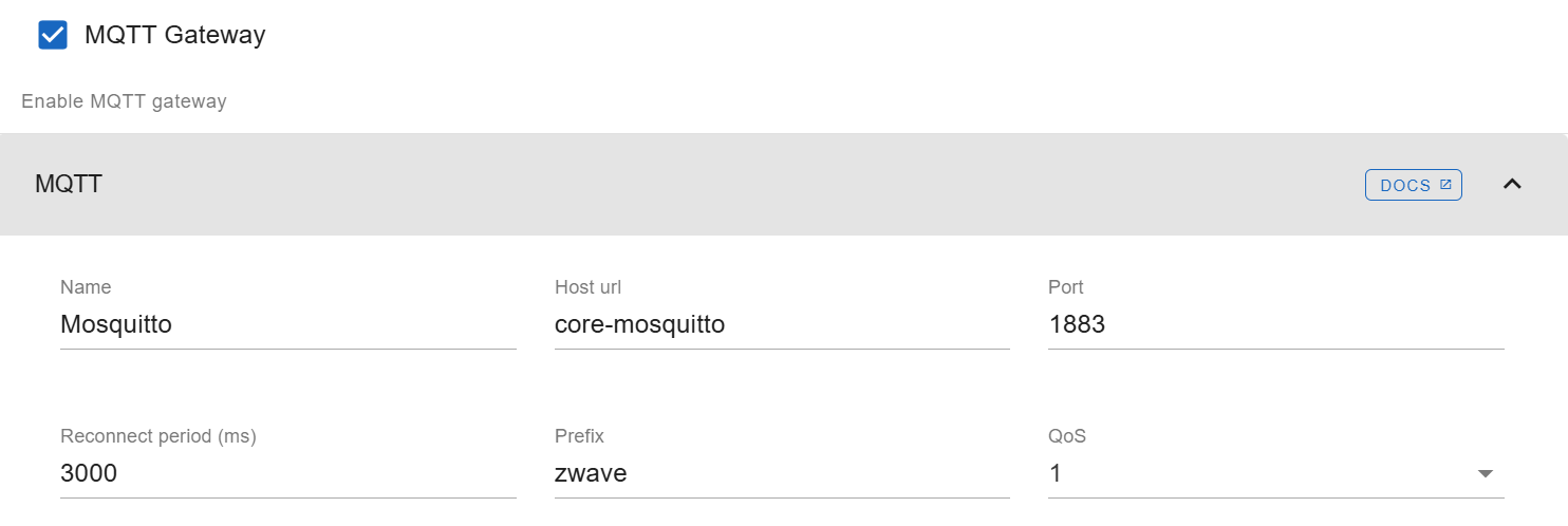

If you connect zwave with mqtt, try changing to websocket. This is done in zwavejs or zwavejsui integration settings.
Your logs show mqtt disconnect so if you are connect zwave with mqtt you will loss zwave connectivity when mqtt is down.

Did you try enable websocket or verify if you using mqtt for zwave
I will try this weekend. Thanks
Where in Zwave JS do I see that it is either mqtt or websocket ?
In zwavejsui it is in settings >> Homeassitant
If you’re using zwavejs, pretty sure it’s in the addon settings.

Zwavejsui web frontend is in the menu options of the hamburger menu in HA’s UI. There you should find settings options and in the setting Homeassitant options. Websocket should be there
I found it. THANKS. How do I change this to Websocket ?
I found how to change it and hope that it works.
