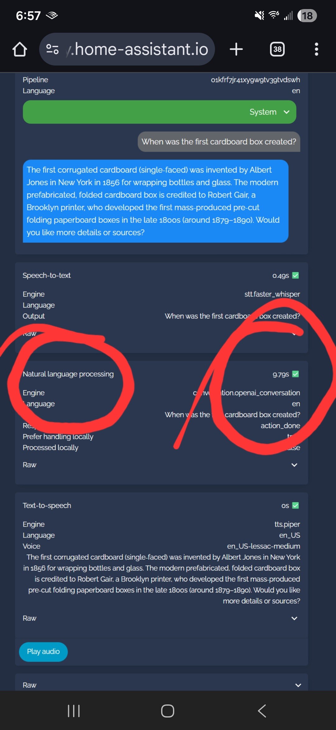

I don't think I'm getting streaming responses. What am I doing wrong?
I’m using a Satellite 1 with a custom wakeword and OpenAI gpt-5-mini for my LLM. It took over 10 seconds before I head a reply here. What am I doing wrong? Or… what additional info should I be sharing?

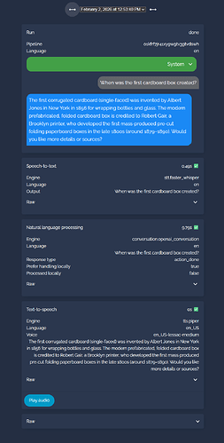

First, look at the information from the Raw block and analyze the timings (or copy the log to LLM for analysis). You’ll immediately know where the problem lies.
Visual blocks display very specific values:
stt - the time between detecting the end of speech and receiving the text result. This may not reflect problems at the audio capture stage.
nlp - the time to process the intent/receive all tokens from LLM
tts - not working, simply indicates that the text was transferred to synthesis immediately. Normally, for long responses, speech synthesis should begin at the nlp stage.
I posted the debug pic. Can you not see it or am I missing something?
edit: And fwiw, I of course pay for OpenAI. I don’t even think they offer a free option.
Yes they do offer free.
9.7 seconds for them to process the inference.
And you’re saying that’s normal? I mean, its fine if it is. Not ideal, but I’ll live. I just want to make sure I’m not doing something wrong.
It’s normal…
