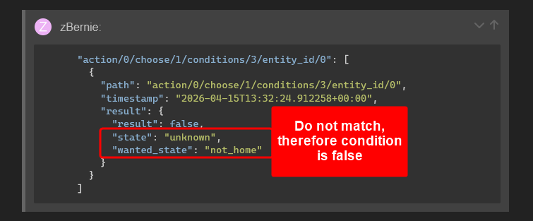

That trace shows the 3rd person has a state unknown in this list:
FYI this info is available in the UI. You have to manually click through each condition in the trace to see it in the results page.

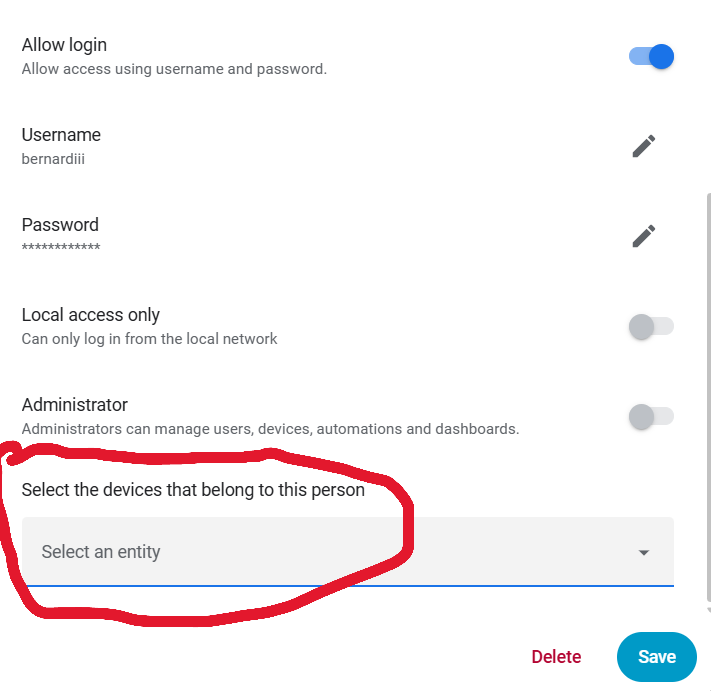

Thank you. I guess the question is why is that state unknown. I just installed HA on my son’s Apple phone last night. He was at school, maybe his phone was off? Could that cause an unknown condition?
I just tested it in the UI and the condition “Did not pass”, even though he’s at school.

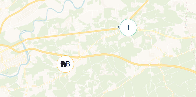

Is location tracking on for HA? unknown means it hasn’t received a location yet. He may have blocked location tracking. There’s a number of reasons why that could happen.
That’s probably it! I did not explicitly enable location tracking on his phone. I just checked HA my phone and see that under Settings → Companion app → Sensors → Manage Sensors → Location zone is enabled. Is that the location setting you are referring to?
FYI, if I look at the map I can see his location, it’s the ‘i’ for iPhone.

Check his person entity and verify that the mobile app device tracker is attached to it. Secondly, there’s location settings in iOS that enable/disable location tracking on iPhone.
Yes, under people he did not have a device assigned to him. But even after assigning his iPhone, the condition still did not pass the test, even though he’s at school. I’ll check his iPhone location settings when he gets home.
Thanks again.
UPDATE: Actually, I entered my Pixel 8 phone in my son’s “Select an entity” option. After I selected his iPhone, it works as expected.
