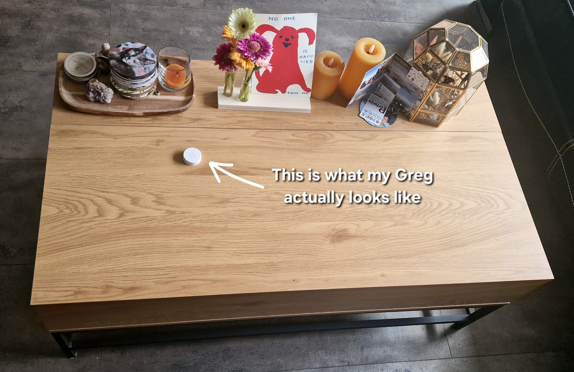

Stick the sensor under or on any surface, point him at any TTS speaker, and he reacts to how busy the room gets. A brush of the table, he notices, Greg always notices. A bit of activity, he's unimpressed. Full household chaos, he has opinions about all of it. And roughly every 42 minutes, if the room's been busy, he has an unprompted existential crisis about being a table. Twenty minutes of silence and he exhales. Metaphorically. He is a table after all.

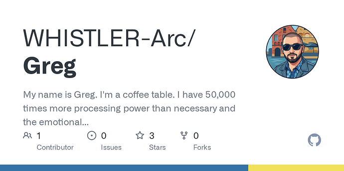

He's free and he's staying free. MIT licensed. You can install him through HACS as a custom repo today, and he's in the queue to become a default HACS integration. That would be hilarious, being the one thing on there that is properly useless. Because it is. :crossed_fingers:t4:
Repo, full install steps, and every one of Greg's lines are here:

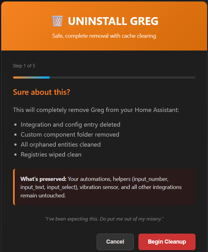

Just a little update;
Noticed during testing that the standard HA delete integration function leaves parts of greg behind. This is not very-Greg like.
If you remove Greg, it should be like he was never there. So he needs a simple Uninstall button that starts a separate cleaning script. Will look something like this:
Let me know your thoughts.

Uninstall is in the final design stage and after that easy to implement.

First testing session was hilarious. I sat there on the couch, sensor on the table & speaker vol up, touching the table. No sound. Dammit. Changing some settings on the phone. A poke, silence, tweak, tap, imire silence, etc.. I see my wife in the corner of m my eye come in and stop. I figured she knew what I was doing and kept going. At this point slapping and and practically punching our coffe table trying to generate increasing levels of vibration. Getting quite frustrated by the silence of the speaker, I finally turn to look at my wife, presumably looking quite angry and saw her expression.. One I hadn’t seen before.
Then I realized: She walked out of the room for a few. min, i decided to try Greg in the mean time. and sees the man she has know (or probably though thought she new) for 26yrs suddenly get mad at the coffee table for no apparent reason. Priceless. :rofl:
