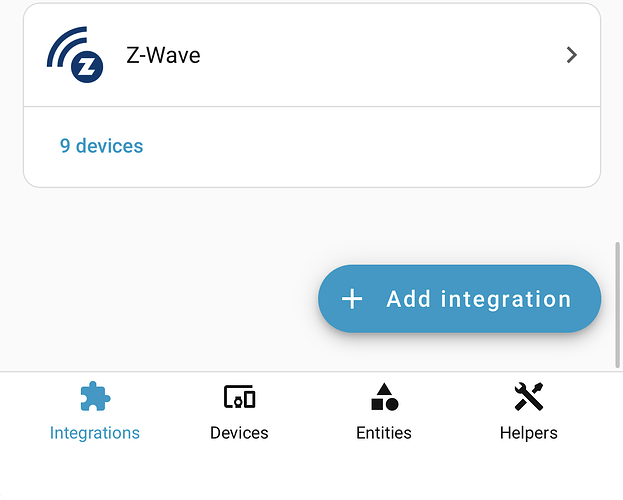

Are you able to add anything successfully to your zwave integration so far?

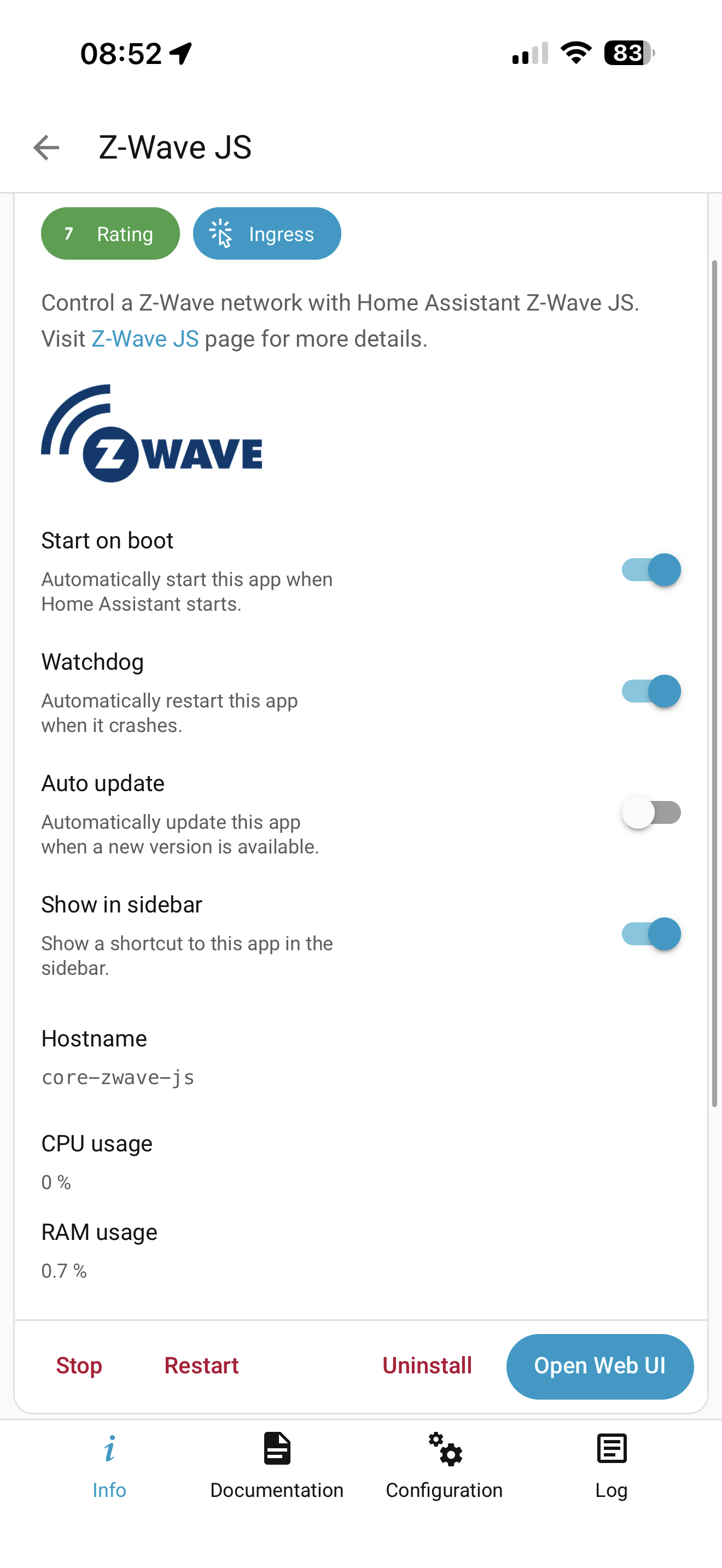

And you have the z-wave js app installed?
If so, when you go there does it show it’s running?
Can you paste a copy of the logs here?
