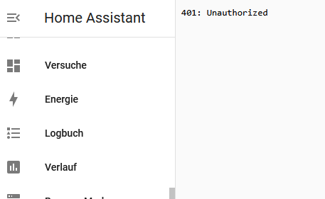

I have an error 401
As of today, I have the problem that the computer from which I access my Home Assistant Server no longer has proper authentication. I can access the regular HA points, but all addons can no longer be viewed.
As if I no longer have access rights to myself. I am logged in as the owner.

I don’t know exactly. I noticed that I can see everything with another browser, but not with my heavily used Firefox.
Dies ist in meinem Firefox
