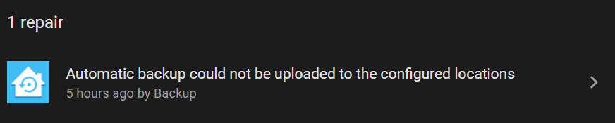

Got an error for a failed cloud upload in the early hours,
which is strange as i’ve never used it before.
I also do not use a Nabu Casa paid account.
Any ideas?

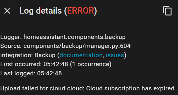

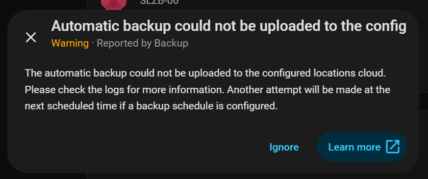

Made some progress on this -
I noticed Nabu Casa was still logged in from the free trial,
once I signed out of this I received a second and separate alert regarding ‘cloud backup’, this time including a link to url/config/backup/settings.
This link took me to a Backup settings page where under ‘Location’, ‘Home Assistant Cloud backup’, also needed signing out.
I’m really not to sure firstly why this feature is on, and secondly why i’m being alerted about it now :-s
