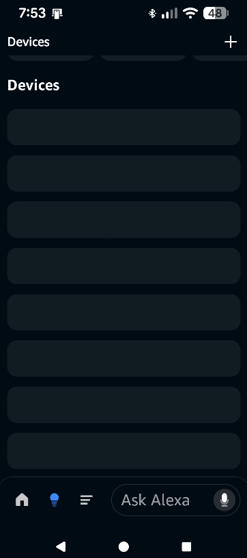

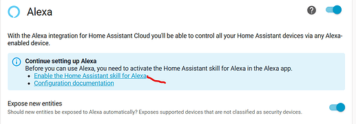

Thank you! I finally discovered how to expose devices and I was in Home Assistant Cloud → Alexa. However, NONE of my Alexa devices were being displayed in the Alexa app, they were all blank (See Fig 1). I uninstalled Alexa, restarted the phone, etc., nothing worked. THEN, about 1/2 an hour ago, I started Alexa and I got a message regarding running Android 12, and that some settings were disabled and would I like to re-enable them, and I did. Still no joy. Then back in Home Assistant Cloud and clicked on the “Enable the Home Assistant skill for Alexa” (See Fig. 2). Subsequently a QR code was displayed on my computer and it said to scan it with my camera, I did, clicked on the link, and now all is well. I am back from the abyss! :slight_smile:

Fig. 1
Fig. 2
