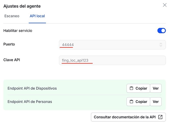

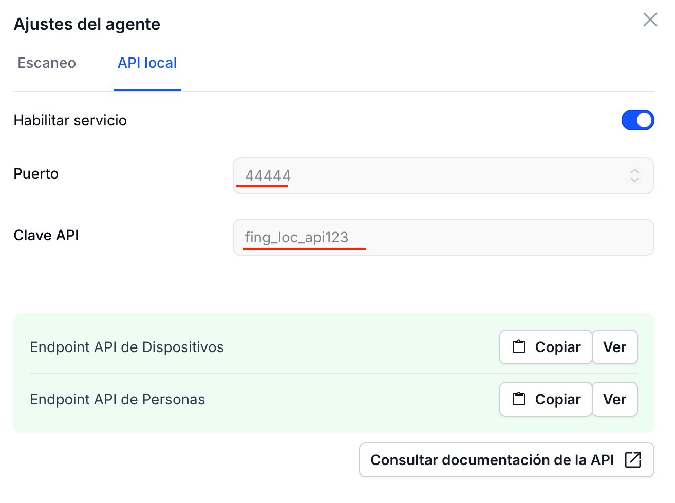

I have the Fing agent’s IP address, the API and the port it’s running on.

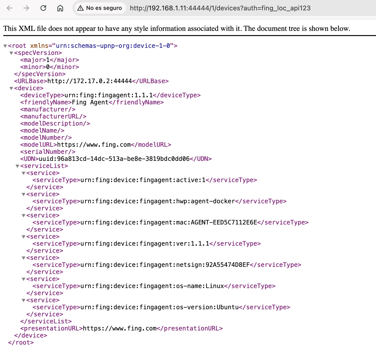

and I can access this Fing agent via a web browser:

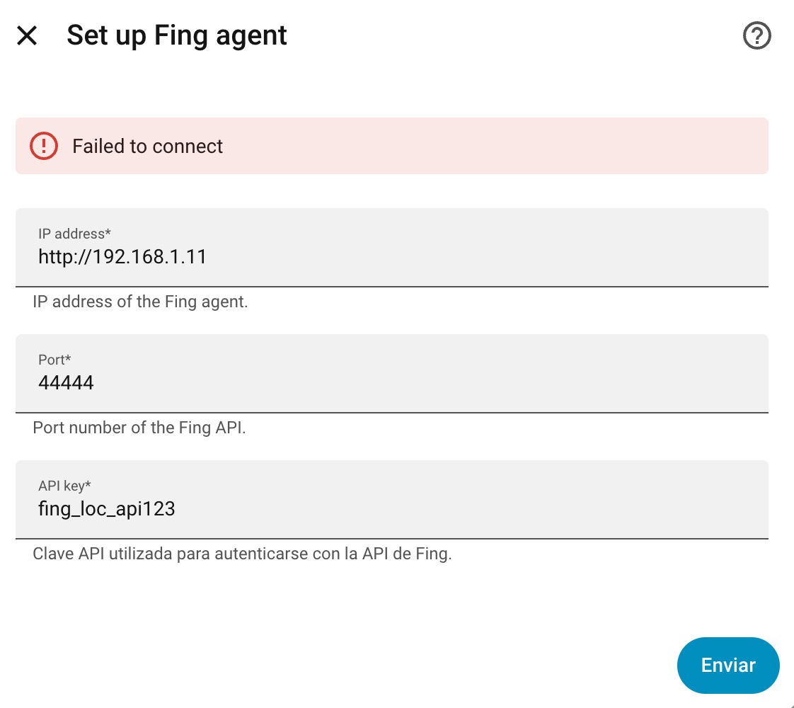

But when I try to configure it IN HA, it always tells me it’s not possible; I enter the IP address both via HTTP and without:
It always gives me an error; if I search for the Fing agent in the list of devices on the network within the Fing app, it tells me that the IP and port details are correct, but nothing happens.

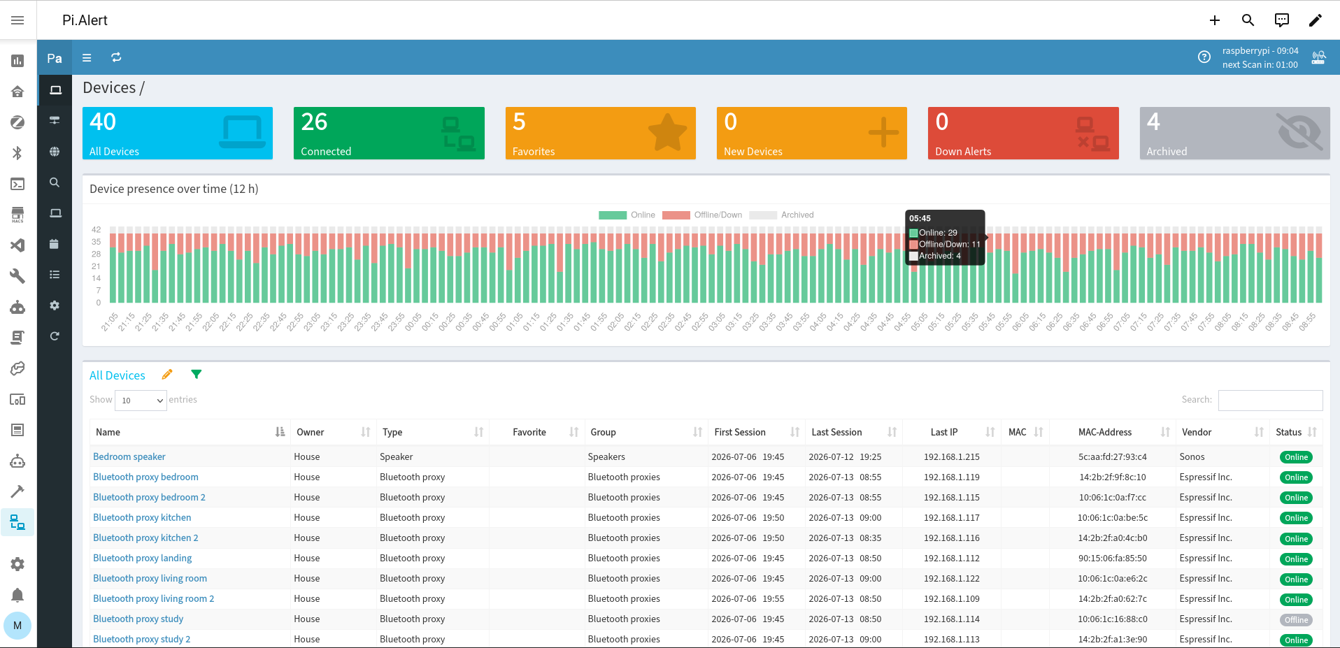

I now use Pi.Alert, which is free and entirely local. There is no integration, but it has an optional API through which you can extract information.
It’s a good fact, I’ll take a look at it to see how it works. Thank you. @RedKing
Although there is no integration, it generates a web page which you can put in a dashboard:
