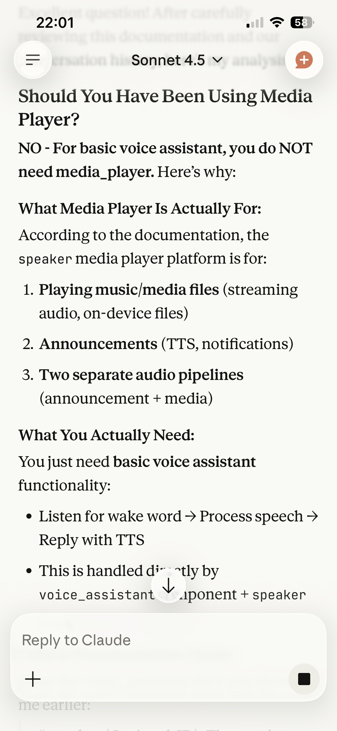

I have read as much as I can, as a non-coder it’s incredibly difficult when researching because the official documentation suggests you know a certain amount which I don’t, although I am trying to learn.
So then I bring in AI or website research and then things get really contradictory - a prime example is my media player question. I am convinced that I’ve read that a media player isn’t necessary with I2S audio, and when asking Claude it agreed.
So as a newbie that’s trying to learn it’s extremely difficult know ‘how’ to actually learn. As per my original post I’ve tried all the things I would think I should try to get a result, multiple products, multiple codes, and more.
Definitely seems like a gap in the YouTube market, explaining this stuff to idiots like me to help us learn.
This is me giving Claude all the information again and looking for confirmation, and this is why I’ve been confused
LLMs WILL confidently lie to you unless you have specifically grounded it in both your subject And given clear directives to not create content
Ask it for a verifiable source on each as proof and chase the links else consider it garbage. This goes for every. single. model especially with things re: Homeassistant or Esphome. They trained the model you’re using last year in bad data. :wink:

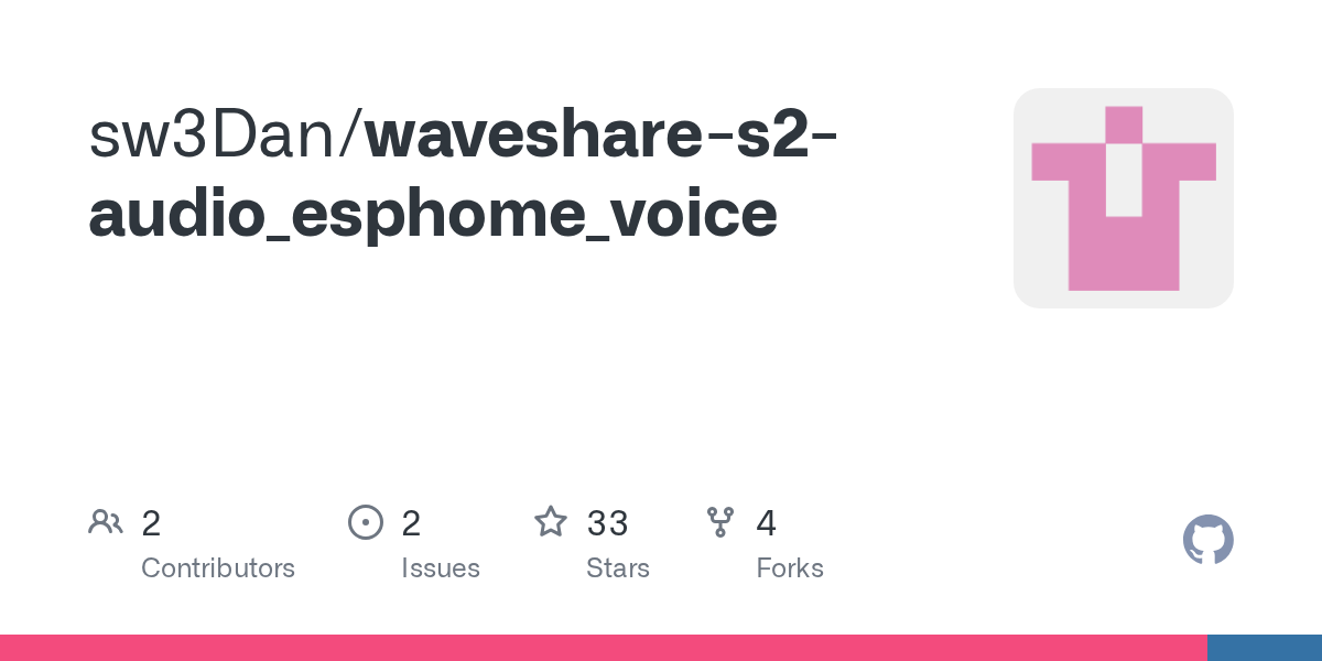

I have some waveshare voice devices. At $15 usd they are amazing. Not as good as HAVPE but definitely $15 good. Perfect to throw in barely used room and walk away

Have you got a link to the YAML you use with the Waveshare please?
