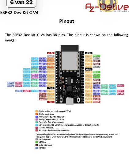

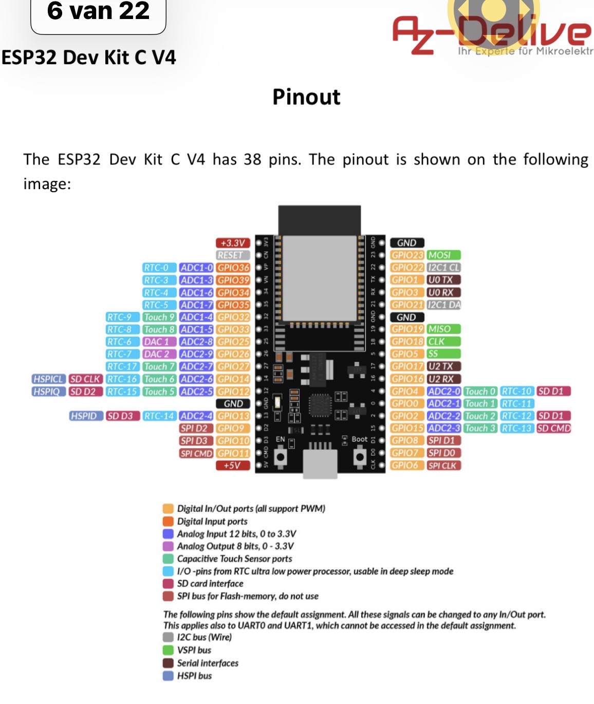

So lets check the possible issues I could think of:
  1. You were using the default RX/TX pins on the board, those are also used for the UART Logging (see docs) but you have disable it with baud_rate: 0 in the logger as I remember. Did you tried with the 16 and 17 PINs and changed the configuration?
  2. The Cable could be inverted. Changing RX to TX would be enough.
  3. The GND pin of the board is faulty? I had once a problem in a random board where a PIN was marked as GND but it was not that (this can be check with the multimeter and check the continuity between the GND pin and others GND Pins and also with the shield of the chip in the board itself).
  4. The Jumper cables are not doing correct contact with the SEC-Touch or are faulty.
I am inclined to believe the cable connection is the problem. I got my connector as gift from the man that did the first pure C++ version. I will try to find out which exact model it is.
Hi again,
thank you for your advice - but unfortunately it is just not working for me :sob:
Here’s what I tried:
  • I restarted the SEC
  • updated ESP Home
  • used two different NodeMCU boards
  • tried all possible combinations with the pins and the jumper cables RX0/TX0/D16/D17/RXD/TXD/G16/G17
  • tried different jumper cables and measured their output with the multimeter to factor out connection issues
  • I am using these “Klemmenblock Stecker” I ordered from Amazon (DE) a while ago which fit the SEC perfectly

With the presumably correct wiring:
  • ESP32 G17 ↔ RX SEC
  • ESP32 G16 ↔ TX SEC
    …here’s what I get from the logs - right after I switch on Fan 6 using the web UI:
[17:56:26][D][sec-touch:065]: [loop] We are waiting for the response after a task of type GET_DATA
[17:56:26][D][fan:021]: 'Fan 6' - Setting:
[17:56:26][D][fan:024]:   State: ON
[17:56:26][D][fan:030]:   Speed: 11
[17:56:26][D][SecTouchFan:107]: Control called
[17:56:26][D][SecTouchFan:121]: New state to 1
[17:56:26][D][SecTouchFan:126]: Setting speed to 11
[17:56:26][I][SecTouchFan:149]: [Update for 178] - [] speed: 11
[17:56:26][D][sec-touch:242]: add_set_task
[17:56:26][I][SecTouchFan:153]: Publishing state of FAN
[17:56:26][D][fan:120]: 'Fan 6' - Sending state:
[17:56:26][D][fan:121]:   State: ON
[17:56:26][D][fan:123]:   Speed: 11
[17:56:26][D][text_sensor:064]: 'Mode Fan 6': Sending state 'Unknown'
[17:56:26][W][component:257]: Component web_server took a long time for an operation (54 ms).
[17:56:26][W][component:258]: Components should block for at most 30 ms.
When I flip the wiring
  • ESP32 G16 ↔ RX SEC
  • ESP32 G17 ↔ TX SEC
    …interestingly I get this instead:

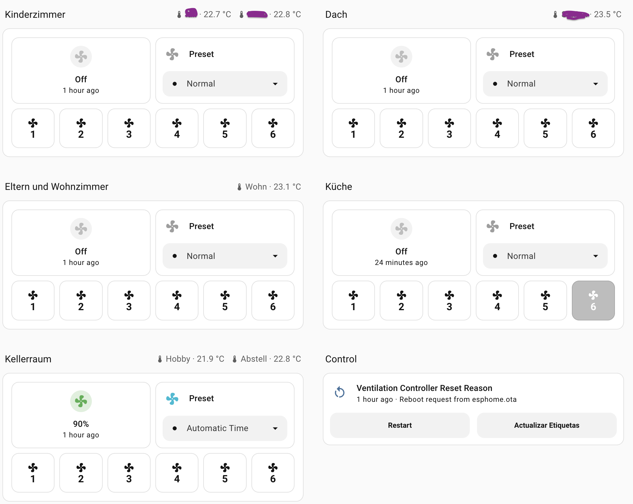

Update: The crashing problems are completely resolved.
The basic functionality is working as expected.
Beside that, turning on a fan now will go to speed 1 if no other speed was set before (instead of go to automatic)
Each patch. has a tag in the github repo, so you can just ping one of them if you want it keep it on some specific version.
Added Example of Buttons with decluttering card into the repo:
Maybe it’s way too late or maybe it’s in over even remotely close to the ax delivery boards issue; but I use those for quite some time now, in over a dozen projects. By reading their e-books you can Maybe I misunderstood what they meant by the find out lots of things about everything they
And: “Also, the Bluetooth Radio has support for the following communication
interface protocols:
● UART HCI interface, up to 4 Mbps
● SDIO / SPI HCI interface
● I2C interface
● PCM / I2S audio interface”
So hopefully this will help configuring things in case someone might be needing some extra information.
