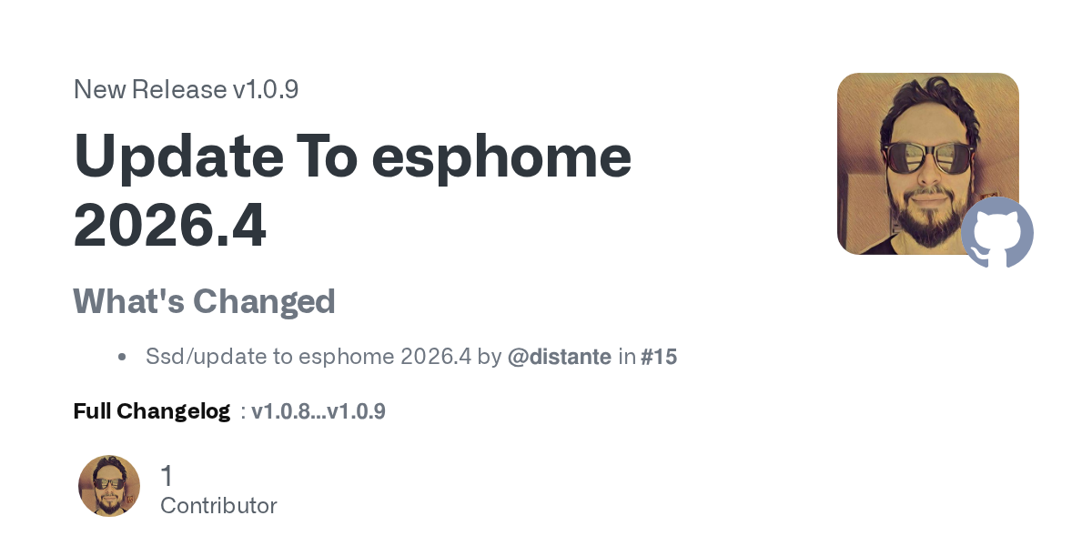

Update for deprecations on ESPHome 2026.4
I have done an update that could help us track which other properties we could control with the device.
Theoretically we can run a full scan, then change some property and run a full scan again and then compare the changes.
