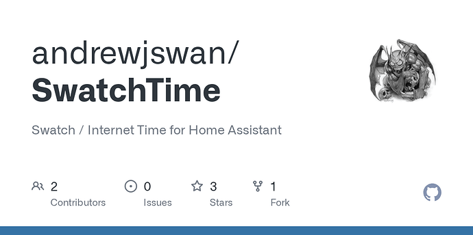

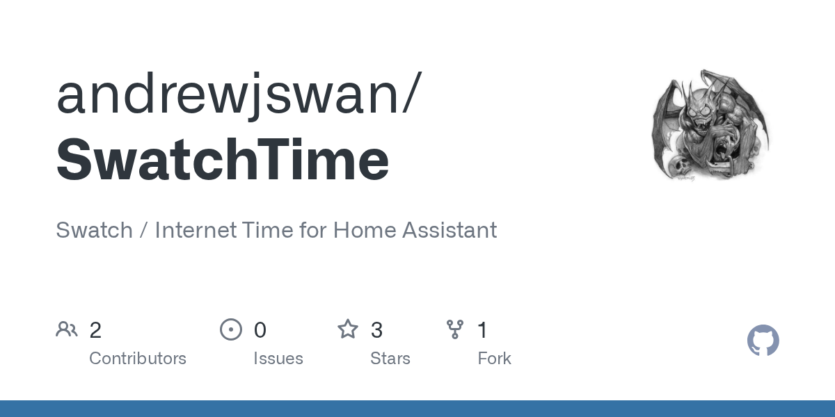

I’m using this from hacs to take care of beat time
