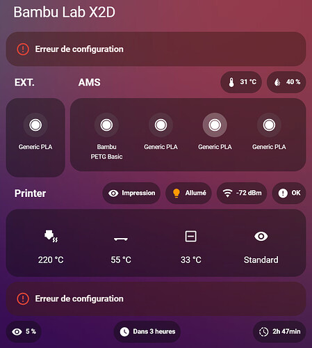

Thank you for all your answers, i’ve added the Bambulab integration in my HA instance, but widgets are prety basics, i’m looking the X1C integration to see how i can make something cool and functionnal
I tried to make my Dashboard, customising the yaml @Nick4 provides, i’m able to have mosts of sensors informations but i don’t know how to have filament color informations, and i want to replace live cam view by the current print picture
here is my yaml, thanks for your help

Is that information (filament color) available by the integration, in other words: do you have something related to that in your HA?

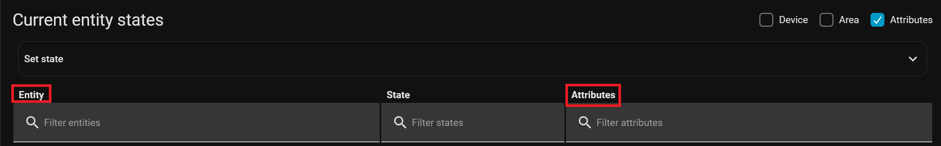

Open your Home Assistant instance and show your state developer tools.
@Nick4 i think you put the finger on one thing, i don’t found any entity with that informations…

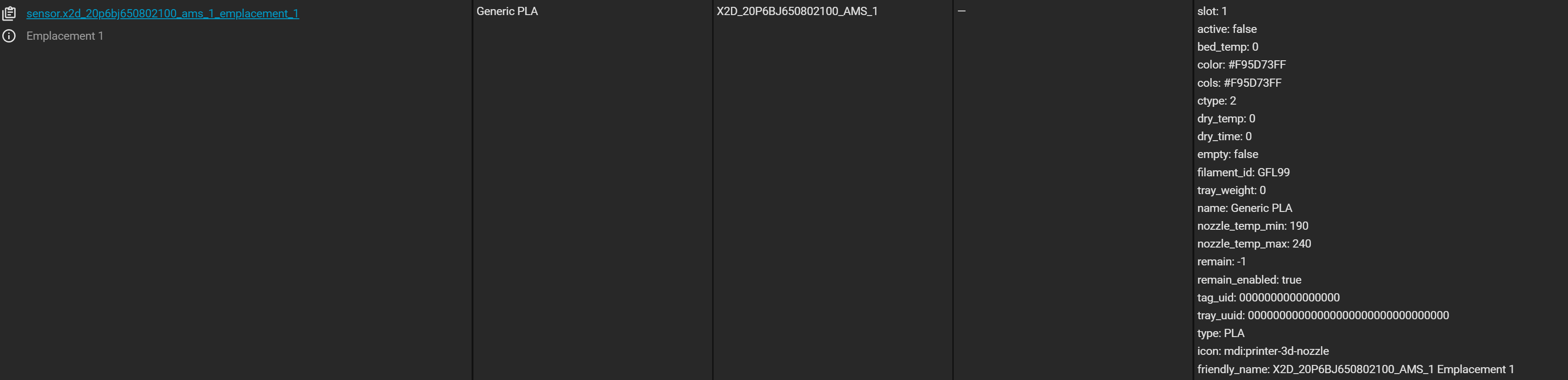

correction with the Dev Tool you sent , i found these informations:
This should be #f95d73ff
Yes it was, but, how can i take this information in my yaml script to show filament colors?
{{ state_attr('entity', 'attributes') }}
Thank you for your advise, i tried but nothing change, i can see in the code éditor, the good value is detected, but not showed, i don’t know how to do
