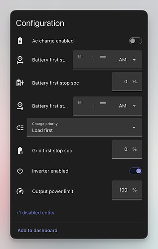

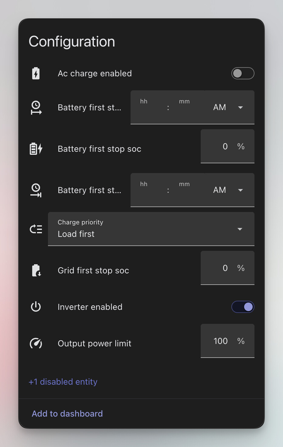

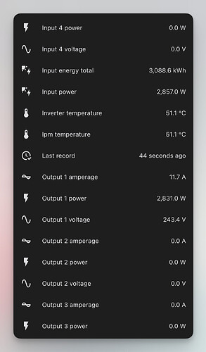

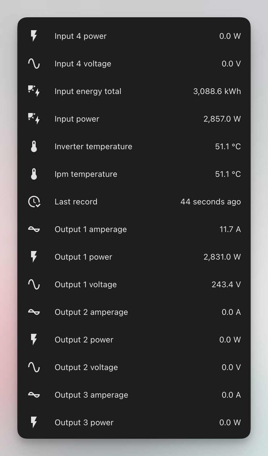

My integration also provides all the sensors and controls to configure the inverter without any extra configuration.

I did notice however that the Solax integration did offer way more details than the original growatt as well as the grott integration :grin:
