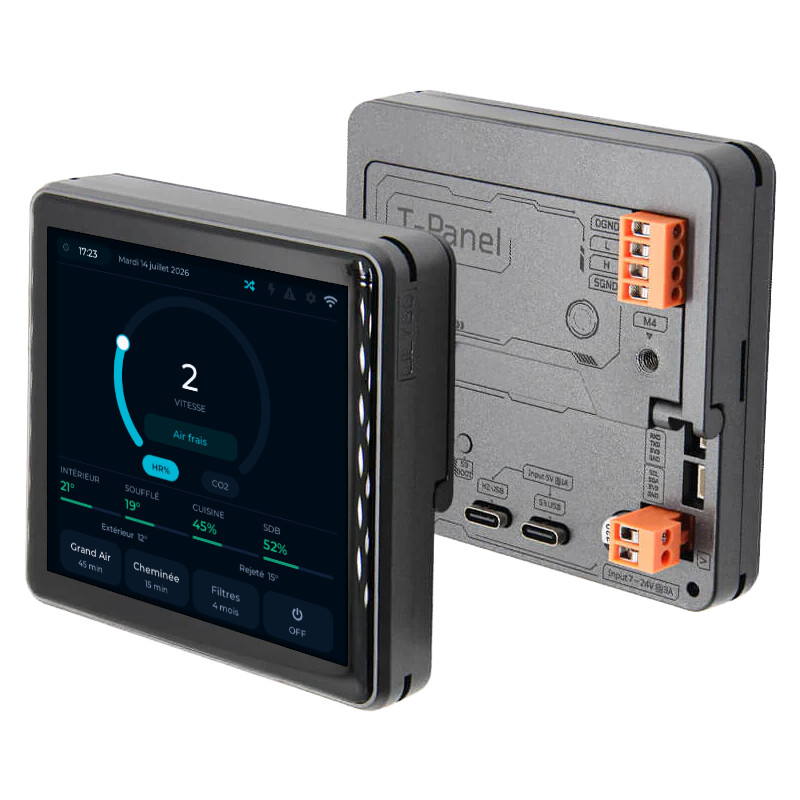

So instead, I spent about €60 on a LilyGO T-Panel S3 and decided to build my own controller.
The LilyGO board is a great fit for this: it features an ESP32-S3, a 480×480 touch screen, a built-in RS485 transceiver, and it accepts a 7-24V DC input directly, which made the integration with the existing wall wiring very straightforward.

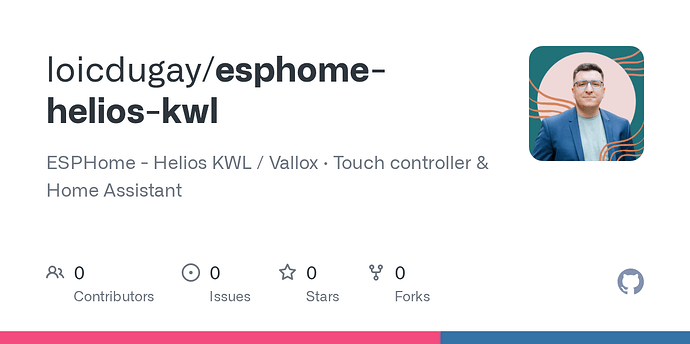

The result is a custom external component for ESPHome. You can find the full code, ESPHome YAML configuration, and documentation here :backhand_index_pointing_down:

  • :mobile_phone: Touch UI: Controls the fan speed (1-8), seasonal mode (heat recovery / summer bypass), and handles humidity & CO₂ auto-regulation.
  • :gear: 46 auto-discovered HA entities: Exposes all 4 temperatures, humidity, fan speed, all setpoints/thresholds (as number entities), diagnostics, and cycles (as buttons).
  • :globe_showing_europe_africa: Easy Localization: Everything is customizable through the substitutions at the top of vmc.yaml if you want to switch from French to English or any other language.
  • :electric_plug: RS485 Custom Component: Uses a custom helios_kwl component that speaks the DIGIT protocol. It listens to the bus passively, polls safely without crashing, and reads back every write to confirm it worked.
  • :fire: Cycles: Boost & fireplace modes with visual countdowns directly on the screen.
  • :broom: Maintenance: Filter replacement reset with double-confirmation to prevent accidental clicks.
  • :thermometer: Screen features: Color-coded temperature/humidity measurements based on comfort zones, and an LCD sleep mode to prevent screen burn-in.
