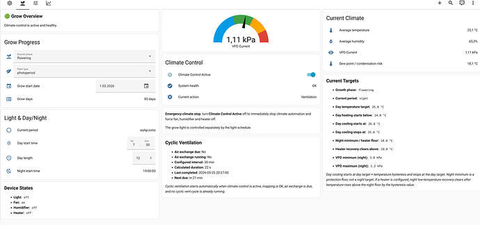

I also built a Lovelace dashboard with Setup, Grow, Settings and Diagnostics views.
Here is the Grow dashboard from my setup:
