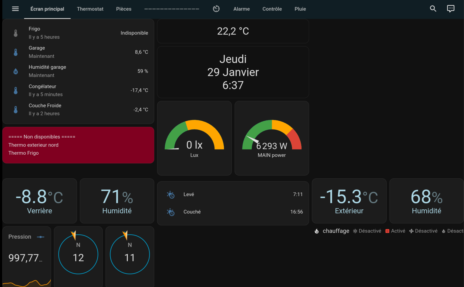

Every now and then he/she (the ghost) press right in the middle of my kiosk monitor and brings the energy screen on.
It is driving me completly crazy. I have searched and searched but that behaviour is still hapening at ay time. I cannot say how long. I have sat in front of it 30 minutes but nothing. Some other time it may happen in 5 minutes. I cannot pinpoint where this is comming from. Well… I have my doughts.
Let’s start from the beginning. I replaced an old iPad with a raspberry pi 4 and a touch monitor 10.1 inch about 2 weeks ago. Since then, I have improoved it and many ways. At that point, everything was working just fine. The screen stayed on 24 hours a day. I was about to be 100% satisfied but then I decided to improove it a bit more…
I decided to make the screen turn off at night so the screen would not bother me in my sleep. Yes I see the light from my bedroom. The screen blanking option of the Pi was working fine except I could not find a way to activate and dis-activate it from a command line. I wished to leave it on during daytime, and off at night.
So I found all the info on the web related to xset dpms etc etc. and the “vcgencmd”,“display_power” and all of that stuff. But none of them worked properly as they either don’t wake up on a touch, or even worst, the wake up at the same time that it selects whatever was underneath the press region. Lucky there wasn’t a DELETE ALL command… :wink: Anyway, I removed all of that (I think…).
But every now and then, it selects the center of the monitor. I know that because I replaced the “on tap” of the card that is in the middle of the screen, and the new place was selected.

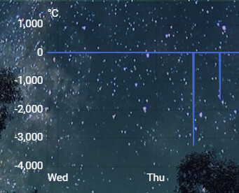

I had this sudden drop in temp yesterday in my house. Could be a ghost. Again could just be batteries.
I actually changed the navigation from the middle button, and the problem showed the new destination. I did not try to remove the middle button. But the testing takes time. For example, it’s has been 4 hours now without the problem.
That would tend to indicate the problem is probably software or configuration rather than physical.
