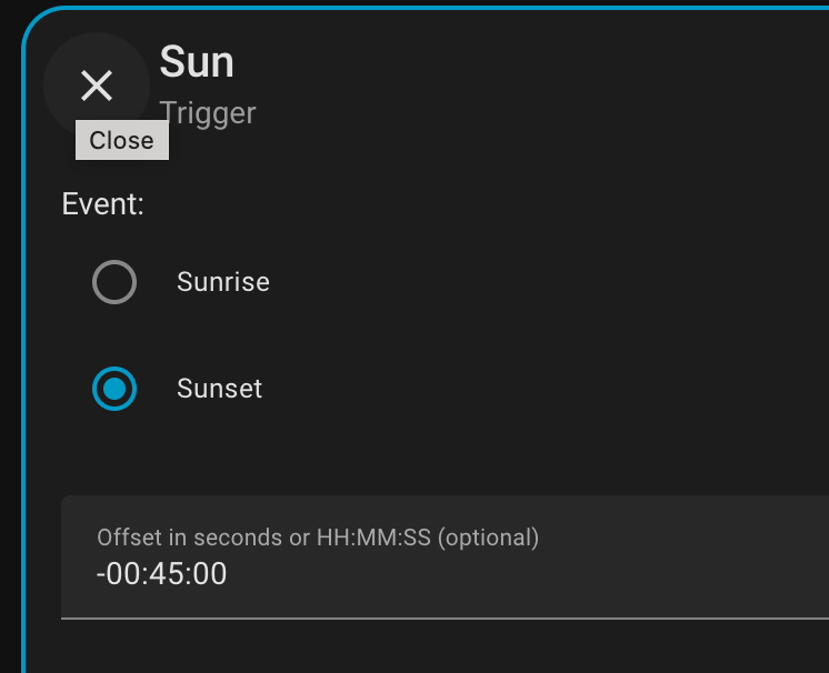

Thank you, I will read of course. For the sunset trigger I have tried again and set up the sunset in the program but does not want to react. This morning I put a time ( 09:00:00 ) to switch on and it worked so the socket reacts to the signal. What can be wrong with the sunset settings ?

Thank you for your help, I used this automation and now it works, the problem was that the sunset time was not correct, but looks like I have found how to sync with my please so let’s see tomorrow
If your sunset is not correct, it means that you have not set the time zone, elevation & location correctly.
Go to Settings > General and double check that all 3 are correct.
Yes, I just did it, thanks
If the sunrise/sunset times are showing correctly now, remember to update your automations :wink:
