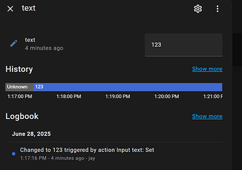

I wonder why the text helper needs to open up a window?
Newbie alert! but I would have expected the text helper UI to be a simple editable text field with a enter/submit/validate button…
1- Why does it need to open a clunky window showing its log history?!

Respectfully I think we don’t understand each other :slightly_smiling_face:. I know how to use the builtin text helper but I don’t want to use it because of the way it works by opening a window and showing its history and logbbook info…

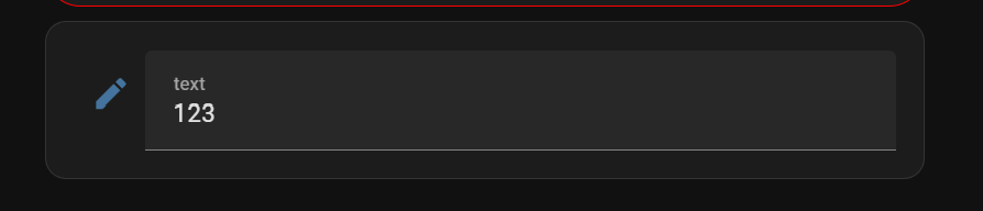

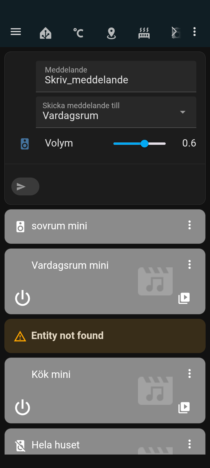

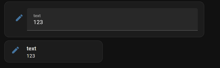

As you can see from my image it is exactly what you are asking for.
So why not just try it?
The text helper entity at the top of my image has the state skriv_meddelande.
If I click on it, I can edit it.
That is what you are asking for.

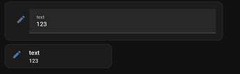

I think he means he doesn’t like this view
It adds as a Tile Card but selecting the Entities Card(as you specified) fixes the issue.

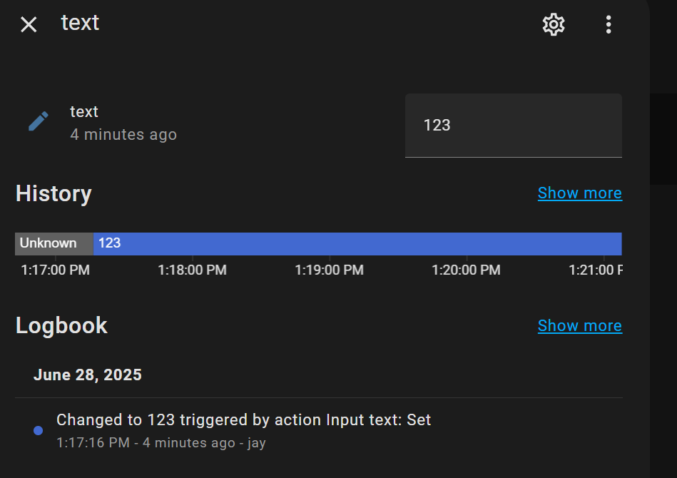

I already tried it. I created a text helper and I put it on my dashboard. It doesn’t show up with an editable text field on the dashboard itself. The only option I have is to click on the card and then a new window opens with an editable text field in the upper right quadrant. Below it are the history and logbook of the helper…
Just like in the video of this guy that I followed.

Add an Entities Card and select the text _input entity you created
Entities Card on the top, Tile Card is below.
OK! I finally understand. and it works!
