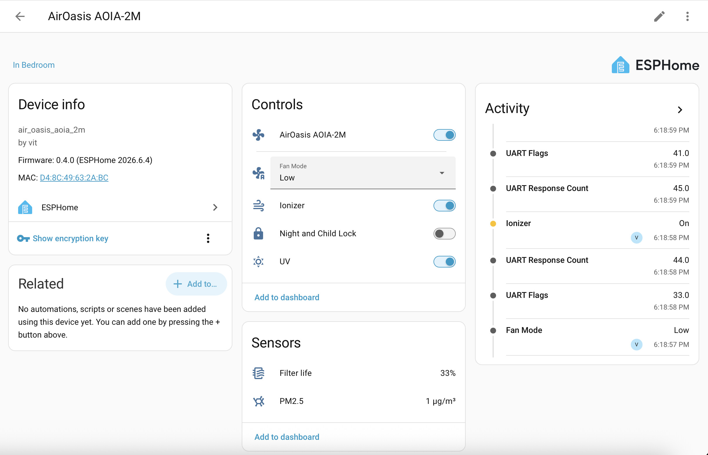

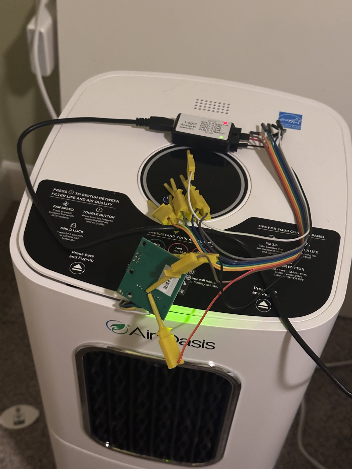

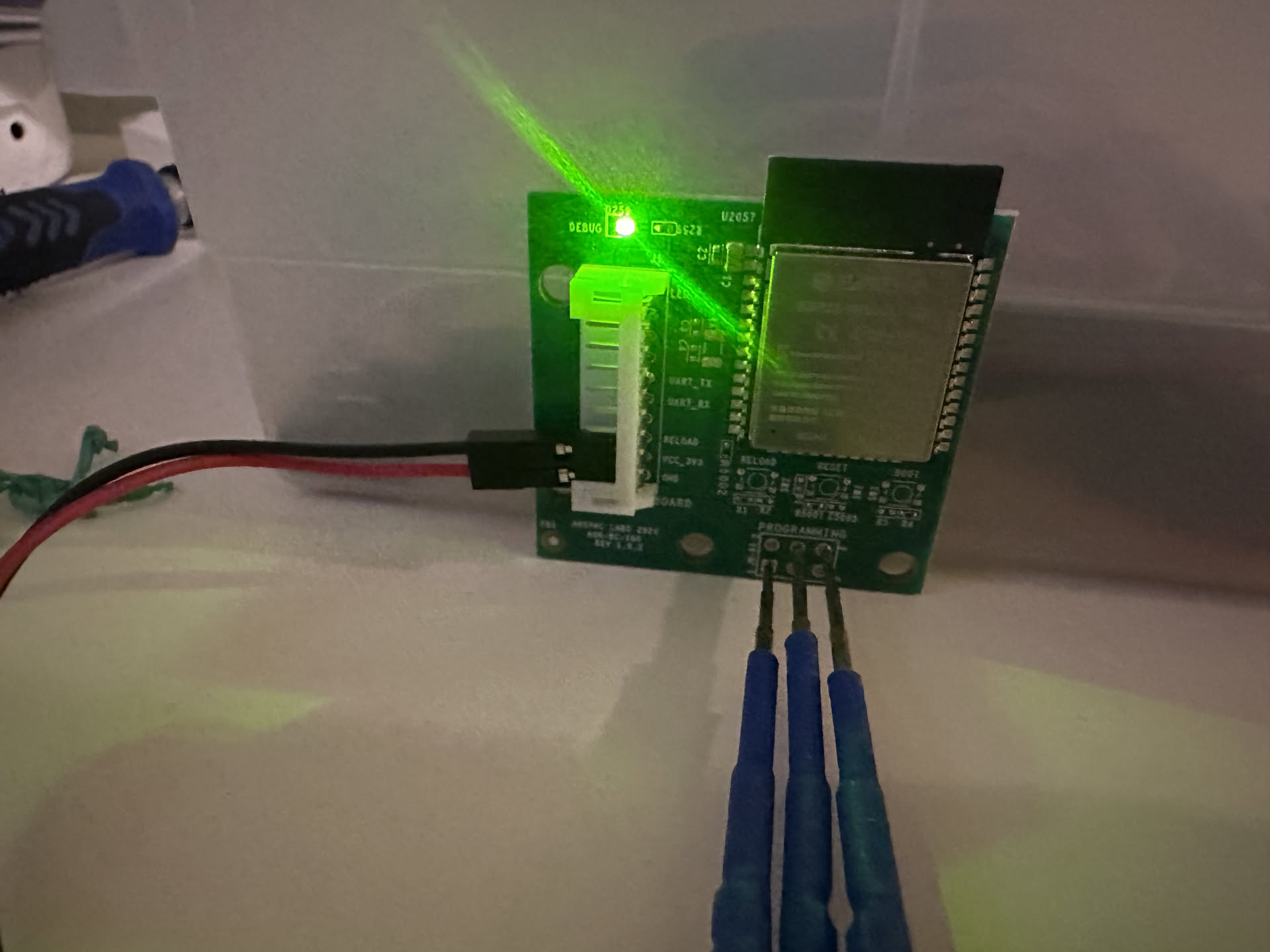

  2. The purifiers feature pluggable wifi modules which talk to the rest of the purifier over UART. Separately from “1.”, I was able to: a) sniff and understand the UART protocol; b) write a fully functional esphome-based replacement firmware for fully local control; c) re-flash the module.
It is all vibe-coded, so it was low effort, but it works well for me. Now, I am wondering if there is any interest in this from others. If so then I can polish this a bit and figure out how to share it (personal github repo? would manufacturers be happy?)

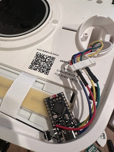

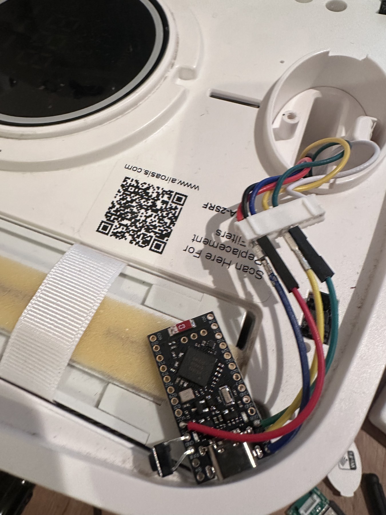

And now I also have a zigbee replacement (a nRF52-based dev board) of the wifi module.
Published: GitHub - lischenko/AirOasisZigbee: Unofficial nRF52840 Zigbee replacement controller for AirOasis purifiers. · GitHub
