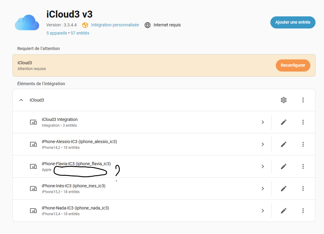

Hi there … for 1 of my devices, Apple like the others, there are no entities for IcloudV3 … what should I check ?
Many Thanks !!

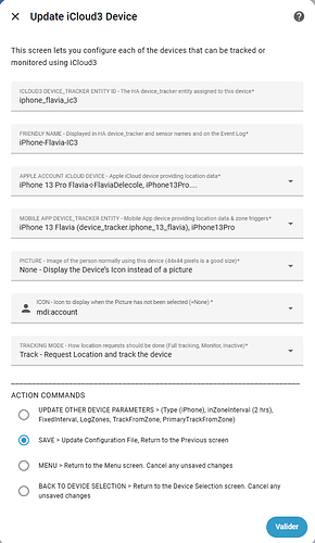

Go to Configure > iCloud3 Update Devices screen, for this device and make sure everything is correct.

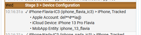

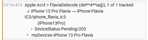

I have re-started Icloud V3 … but can not see anything strange :

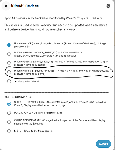

Update device screen also seems correct :
then next seems to be Delete and readd via Configure → Devices List screen ?

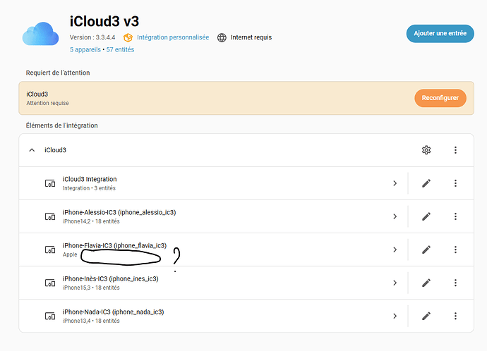

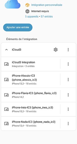

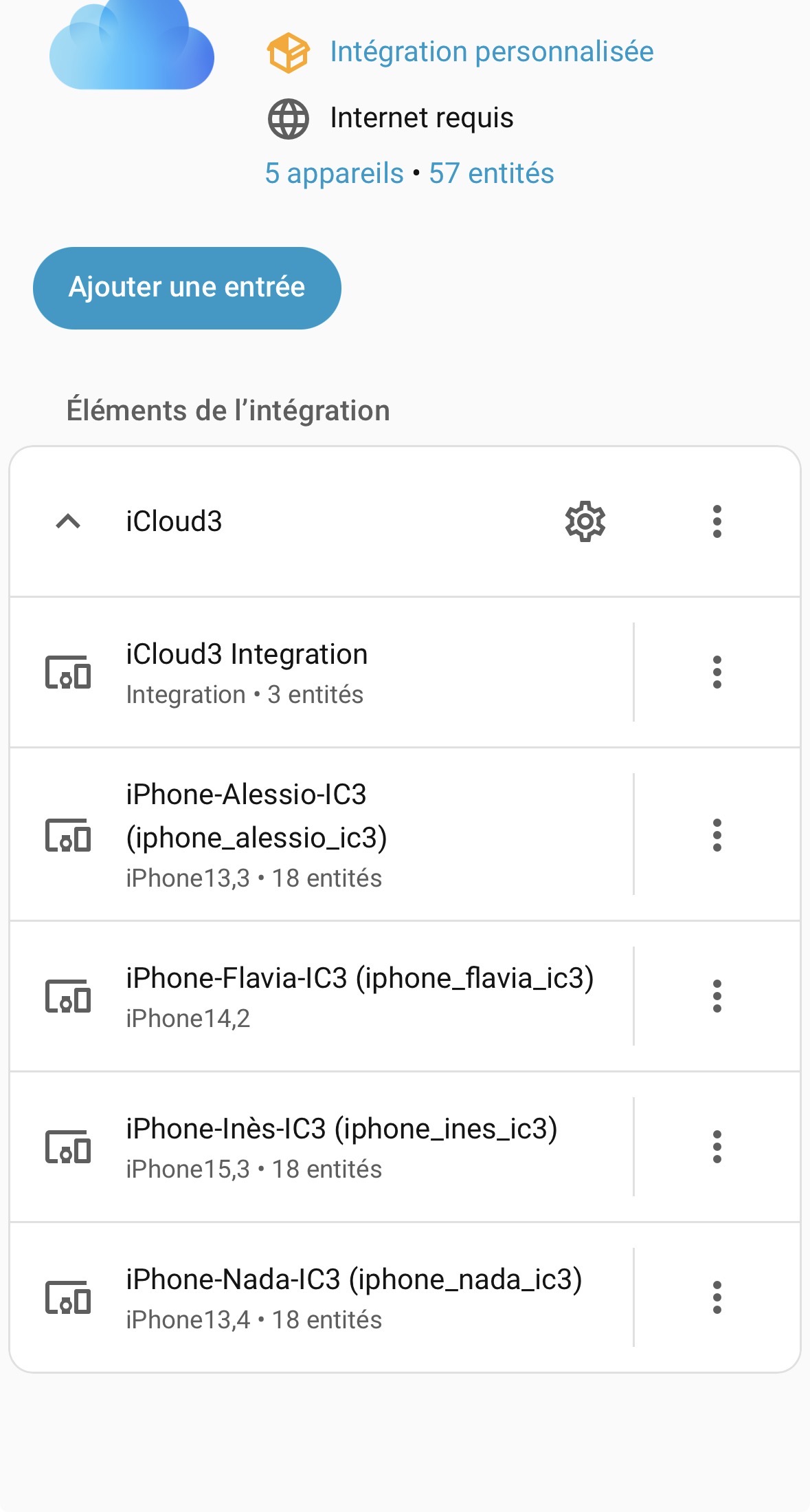

mmm I have deleted the device and re-created it, still no entities created and nothing in the log
Many Thanks
@cedricdelecole

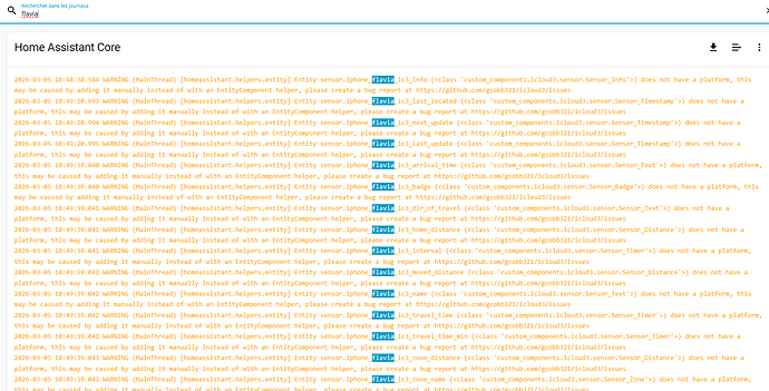

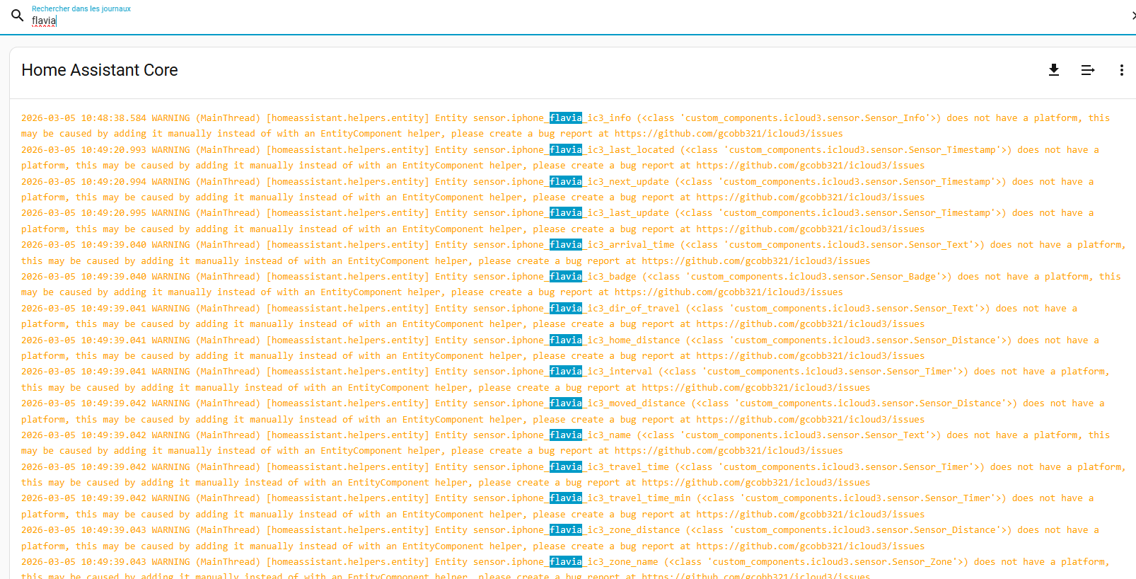

Go to HA Settings > System > Logs. That should display your error messages with the info that causes it. It will not say iCloud3. Click on the latest and it will indicate the module that caused it at the end. Look for something that has icloud3/config_flow in it. Post the complete error that should show what caused it.
There must be some data error associated with that device in the config file that is creating the problem.
Email .storage/icloud3/configuration to [email protected] and I’ll look at it
Thanks a lot @gcobb321 … I can only find this in the Ha log :
nothing on “config_flow …”
I send you the mail now

The problem is the device and/or sensors was disabled using the HS Settings screens. This creates a conflict with iCloud3 when it creates the device and sensors on the next restart.
iCloud3 v3.3.5 deals with this. I will be releasing it next week after further testing but have included it below.
I have released a Beta version you can download. See here
Review item 2 and 3. After install, go to Tools > Cleanup HA Registry , select the device that does not have any sensors (it may be in several categories), select Delete Selected devices. You ma have to do this several times.
Then restart HA or Reload iCloud3 on the Tools > Reload iCloud3 screen.
