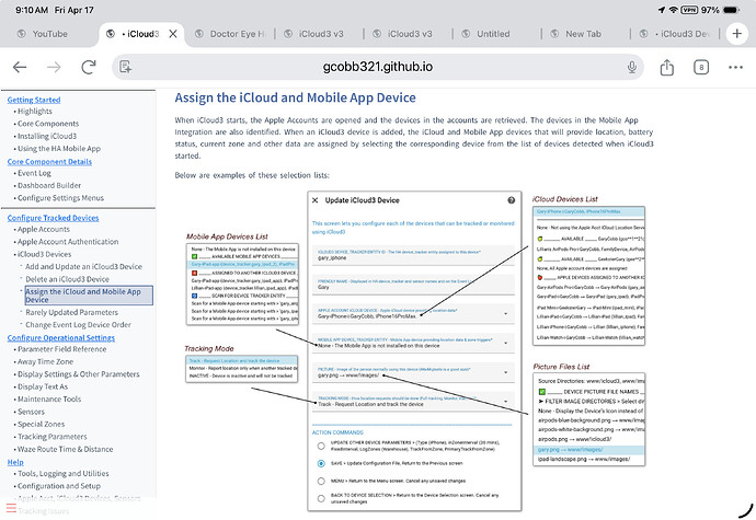

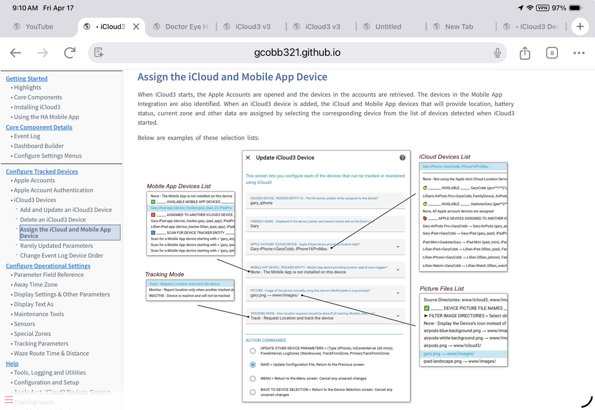

Go to the Configure > Update iCloud3 Device screen
The what now? Where?
On the device?
Do you mean Settings>Apps>Home assistant? there’s no MobApp entry there.
In the iCloud control panel?
Under the purple gear configure menu there? If so, which entity because there isn’t one named “mobapp.” is it "sensor.icloud3.alerts?
There is no menu option or button for “update iCloud3 Device” I can find.

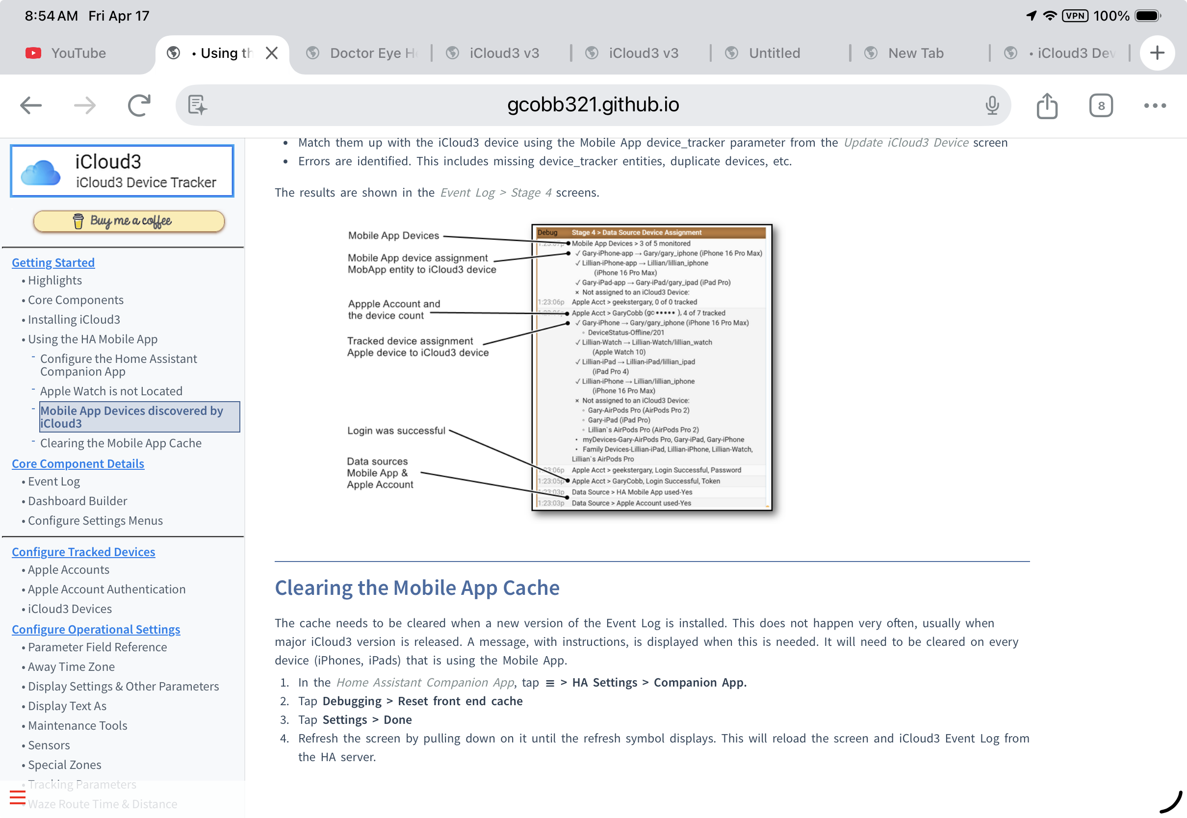

It appears you are a little confused on what this do right now. I would suggest you head to the iCloud3 docs which explains how iCloud3 and the mobile app work together.
  1. Click the purple question mark (?) in the top right on the Event Log
  2. Start with the section Getting Started > Mobile App and Configuring Tracked Devices > iCloud3 Devices
The what?
I’m sure what you’re referring to exists at these links somewhere, but there’s no such link as “Getting Started > Mobile App and Configuring Tracked Devices > iCloud3 Devices”
I’ve been through the Settings in the Mobile App and they are configured correctly.
Except maybe I haven’t done " * Match them up with the iCloud3 device using the Mobile App device_tracker parameter from the Update iCloud3 Device screen*" Because where is the “update iCloud3 Device” screen?

Right I’m on that page, but two things:
Minor–
isn’t the name of the link. do you mean some sort of popup on hover? I don’t get any.
More important-- that page tells you what to do, but not how to do it. I don’t see any actual instructions on how to " Match them up with the iCloud3 device using the Mobile App device_tracker parameter from the Update iCloud3 Device screen".
@DifferentComputers
You are looking in the wrong place for info on configuring iCloud3 device.
all right, that got me to the right place.
thank you.
