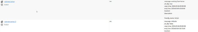

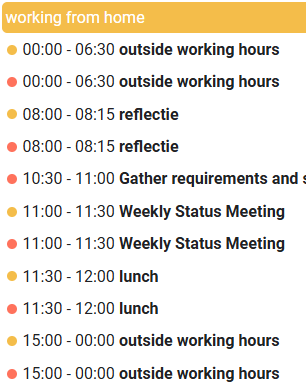

One thing that remote calender does not do, is filter or at least it does something weird with all days. once an all day is active, no other events get active, where as with ICS platform you’re still able to, see screenshots
action = remote calendar
action_2 = ICS platform
