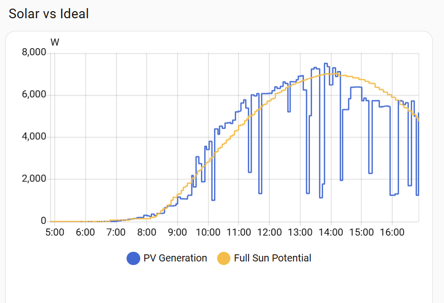

I’ve created, helped by AI, a few Template sensors that calculate the full sun ideal output throughout the day that I can overlay on actual output. It’s not perfect but close - and I’d be happy others to suggest improvements to the templates. Anyway this is what I’ve done…

Finally, these are pulled together into the sensor that shows what would be generated under full sun conditions for 1 set of panels…
sensor.full_sun_potential
Unit of Measurement - W
Device Class - Power
State Class - Measurement
The Template
{{((states('sensor.house_solar_aoi_factor')|float(0)*
states('sensor.atmospheric_attenuation')|float(0) * 6750/100) +
(states('sensor.diffuse_solar_factor')|float(0) * 6750))|round(0)}}
Amend the 6750s here to whatever your rated peak output is in W.
