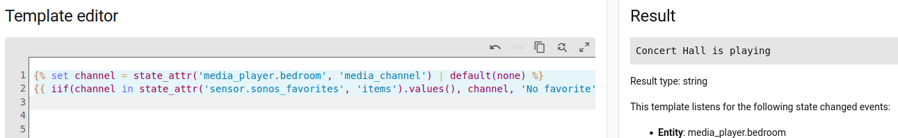

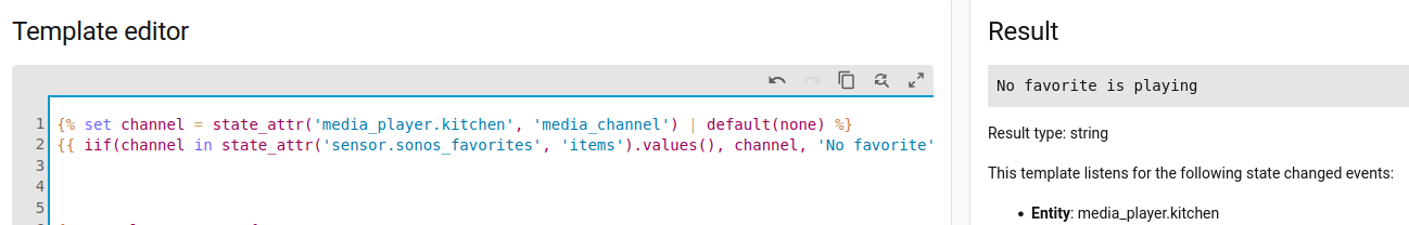

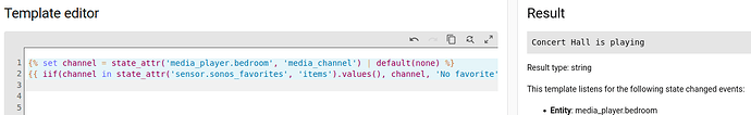

When I play a selection from Favorites, the chosen media_player acquires a media_channel attribute. This template reports if the attribute’s value exists in the items attribute of sensor.sonos_favorites.
{% set channel = state_attr('media_player.bedroom', 'media_channel') | default(none) %}
{{ iif(channel in state_attr('sensor.sonos_favorites', 'items').values(), channel, 'No favorite') }} is playing

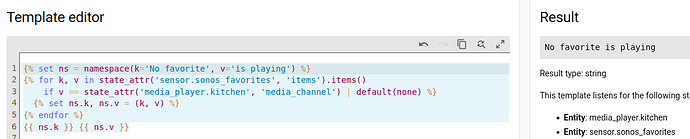

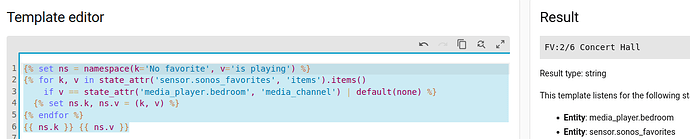

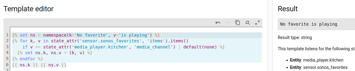

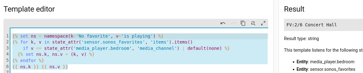

If you need the both the Favorite key and value then here’s a way to do it.
{% set ns = namespace(k='No favorite', v='is playing') %}
{% for k, v in state_attr('sensor.sonos_favorites', 'items').items()
    if v == state_attr('media_player.bedroom', 'media_channel') | default(none) %}
  {% set ns.k, ns.v = (k, v) %}
{% endfor %}
{{ ns.k }} {{ ns.v }}
