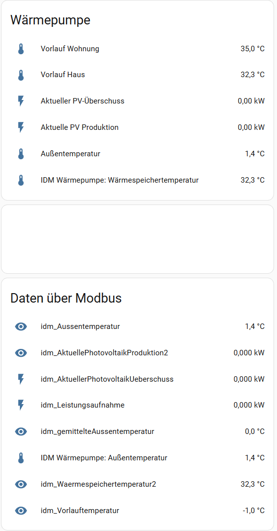

Dashboard (1x hacs/idm integration + 1x modbus):
will send it as early as I have the permission to put more than one integration in the post

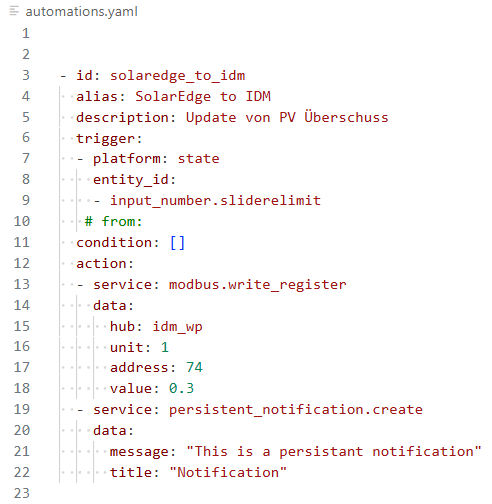

automation.yaml:
Does anybody have an idea what the reason for this could be ?
Is there any problem with parameters at the idm heatpump themselves ? Reading works… only writing doesn´t.

screenshot Dashboard for values taken from hacs/idm integration and modbus:
