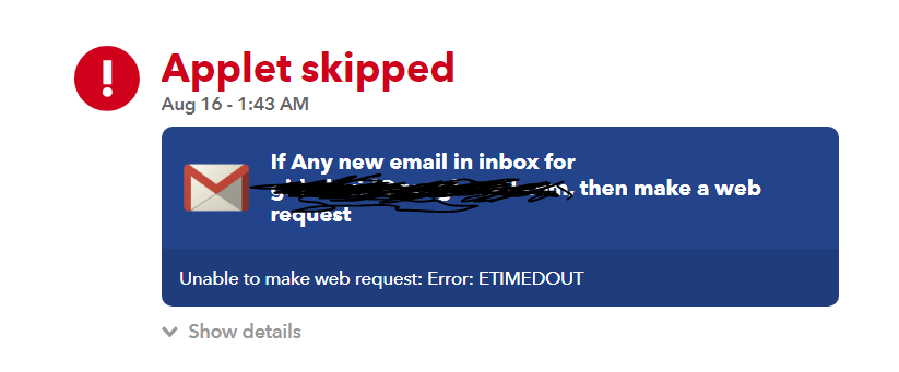

So if I trigger (via dev- service) I m be able to communicate with IFTTT and start my IRobot
If I try to trigger (via Email) this Applet I m getting this error
Does anybody have a clue why I can´t receive triggers from IFTTT?
