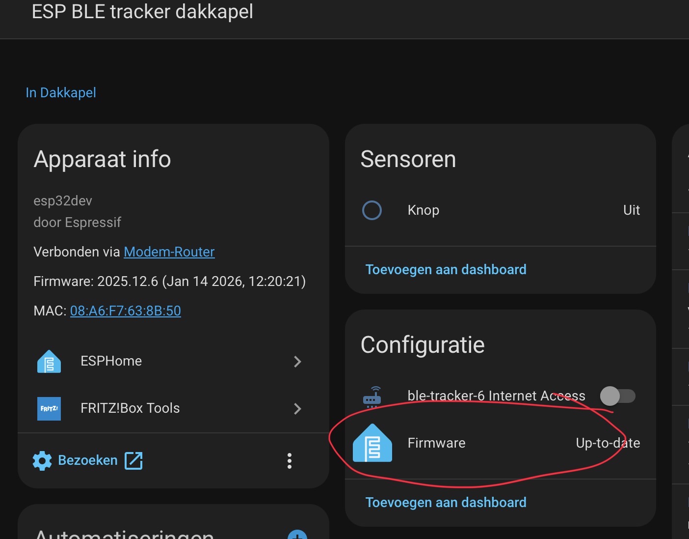

Its firmware . Its usually under configuration
It’s a long time that trick doesn’t work anymore to prevent HA notifications for ESP devices that needs updates :frowning:
Which trick do you mean? If you disable entity “update.esphomename_built_in_firmware” (or similar named, i have names in slovenian language and i’m translating “by guess”) then it won’t bother you with updates.

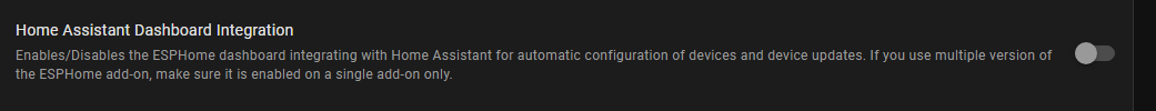

You can disable this for all devices in epshome addon’s configuration by disabling this:

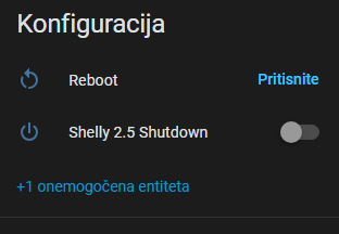

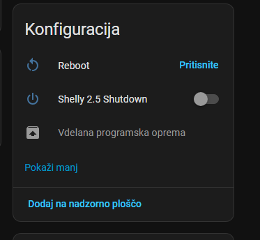

It’s odd, though, that you don’t have this entity in esphome device’s page… Even if it’s already disabled it should report “+1 disabled entity”:
(grey last entity means it’s already disabled)

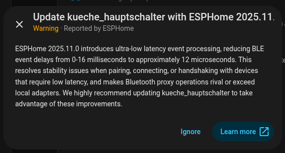

Do you guys have an “update” button on these warning messages?
They definitely work, because I use them to skip updates or install them in automations. They are what trigger the repair notices, and they allow granular control over what ESP’s you wish to ignore (in contrary to the globl option mentioned above). If you don’t have the ESPHome addon things may be different. But then I would not expect you to get HA repairs at all (except for special ones, I’ll get to the one mentioned above later).
Note that HA repairs are not the same as update indications in ESPHome. those are not by HA.
For the scripts that operate on these entities by either skipping updates or installing them, see my answer here:
The repair mentioned by @kiesel above is not a regular update alert, but a specific one to warn you for potential problems with older versions. Ignore those at your own peril.

Any way to turn those off? These devices do what I need at the speed that I want. Fiddling with them means potentially having to dig them out of the walls.
