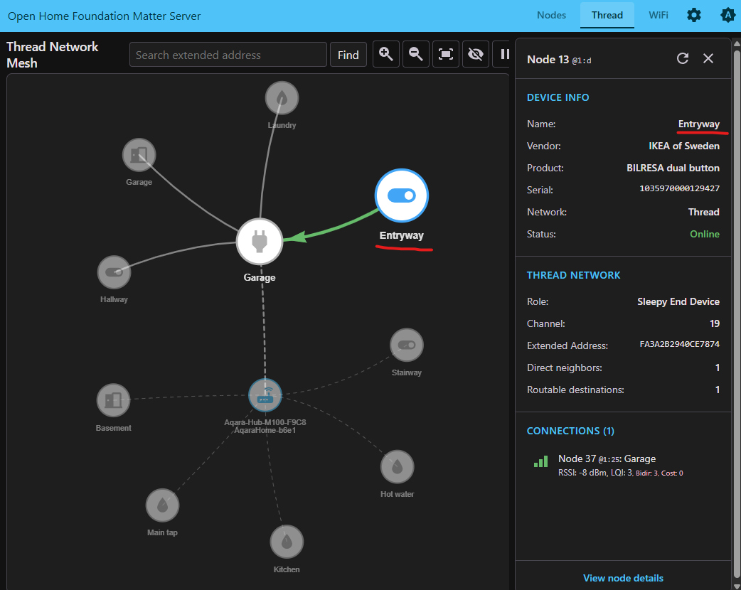

It will be hard to say without knowing what parent node it's attached to. If you have a way of getting the Thread topology then one should be able to see which node it is attached to and then move it closer to that node.
If you don't have a Thread topology map, then one suggestion would be to move it close to the TBR, pull the batteries out for about 10sec and put them back in. Hopefully it will attach to the TBR. Then after the device has come back up, start the download which will hopefully make the download quicker. After it has finished, then when you move it back to its desired location, do the battery re-insert again to make it join a nearby node.
However, please note there is a caution in the upgrade instructions to not remove the power while the updated is in progress!
I first moved my devices next to the antenna with no effect. But when I moved them next to the node through which their network connection is made, they updated pretty quickly.
The position of my problem Bilresa #1 didn't seem to make a difference, whether near the border router or near its nearest usual neighbor. Also when I took out the batteries and then re-inserted them after 10 seconds I got nowhere.
