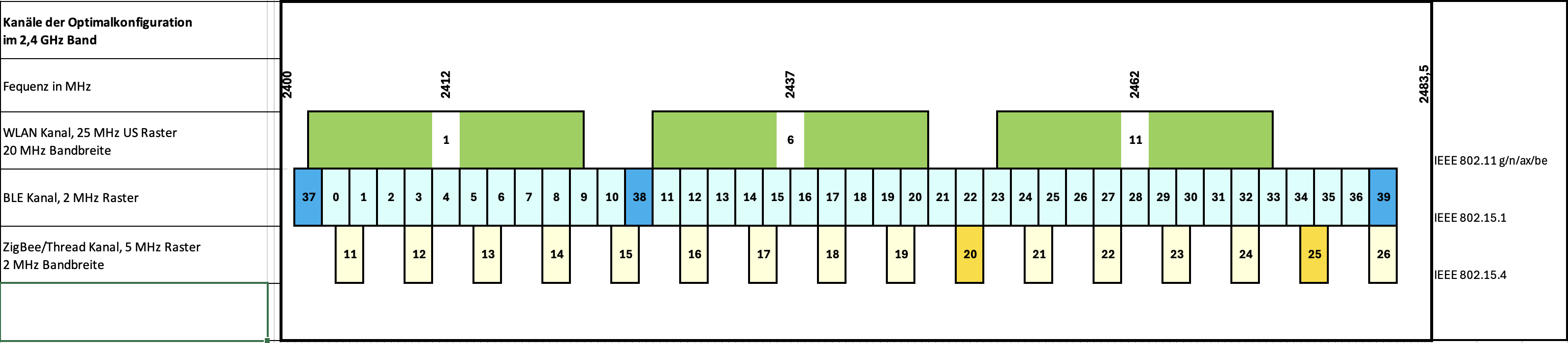

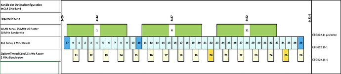

Okay, but both channels (15, 26) are usually not optimal. You might want to look at your WiFi channels and also at the usage of Bluetooth devices. Here is a nice chart that shows the overlapping and free channels of WiFi/Bluetooth and Zigbee/Thread:
In general: when you keep your WiFi Router set to US-Scheme and only use channels 1,6 or 11 in 2.4 Ghz with Bandwidth limited to 20 Mhz, you can safely use channels 20 and 25 (orange marked) for Thread or Zigbee without getting interferences with your Router (green marked) and Bluetooth devices (blue marked).

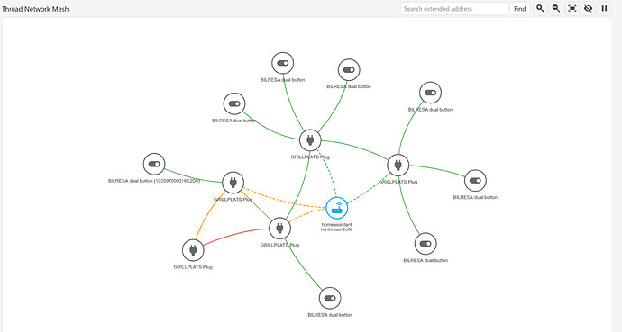

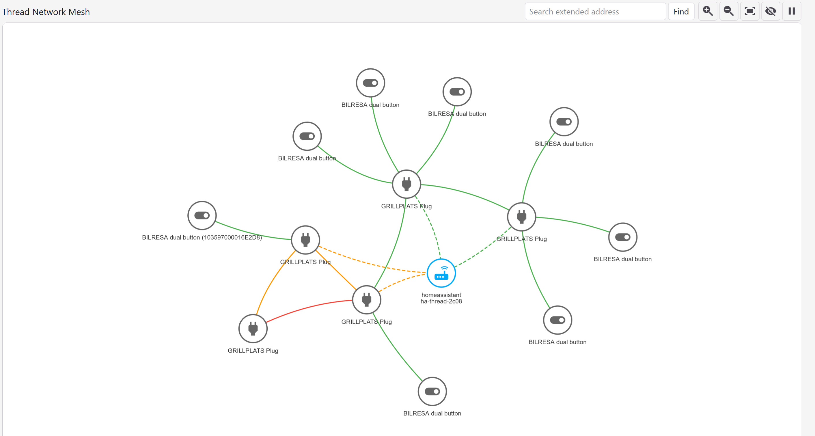

The Matter server Thread display does show abnormalities for 3 of the Grillplats.
I have no idea which one is which, though.
Some progress.
  1. I was able to find the Bilresa and Grillplats Node ID in Home assistant under Settings/Devices/Matter/device name. The "Matter info" doesn't initially populate. It takes a few seconds for it to display. Then, I have to click on it. Finally, the node ID appears.
  2. In the Matter server GUI, I was able to update the node name by clicking on Node / Endpoint 0 / Basic information / Node label . I did so for all 5 Grillplats and 8 Bilresa.
  3. I then was then able to get a more useful network view.
  4. I could still not update anything.
  5. Since it's now, daytime and lightbulbs are not needed, I flipped the relay to off on the 72 Z-wave light switches. This powered off 221 Wiz light bulbs, which would have reduced utilization on Wifi channels 1, 6 and 11. This should have had no effect on the Thread network on channel 20, as its spectrum does not overlap with these Wifi channels.
  6. Nevertheless, I was then able to successfully start the update on one of my most distant Bilresa, which is behind 2 Grillplats repeaters, without having to move it. It took about 10 minutes from start to finish.
  7. I have still had no luck getting any of the other 7 Bilresa to move past the initial "Installing" state.
  8. I pulled and reinserted the battery on some Bilresa in an attempt to force them to reconnect to the nearest repeater. The reconnection worked. However, the Node label configured in step 2 was lost.
