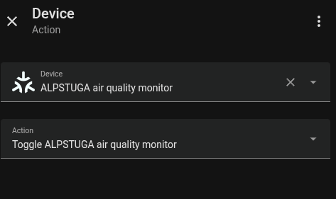

May I ask, where is this action?
The only button I see is for the device and it is only an “identity” button.
Ah I see…that’s a Device Action.
That’s nice :slight_smile: , however in my case the Toggle just turns the ALPSTUGA display on/off.
Ah that’s right!
