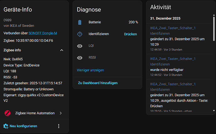

Hey @iamjosh,
thanks for your contribution. I was able to pair my Bilresa 2 Button Device with ZHA, but unfortunately the button presses are not recognised.
I also added your custom quirk as suggested in your github instructions.
Has anyone else tested it so far?

HAOS (2025.12.5) via Proxmox, ZHA, Sonoff-Dongle-M. Other Devices, like IKEA Styrbar are working correctly.
Yes, custom_zha_quirks-folder containing bilresa_v2_py-file.
I also added the directory to the configuration.yaml
zha:
  custom_quirks_path: /config/custom_zha_quirks
I Guess?
No, there are no events beeing fired by pressing the buttons :frowning:. I thought your custom quirk would help, but
Seems like I have another issue …
Yes the quirk is applied.
My troubleshooting steps would involve a couple of things.
I would remove the device from ZHA. Remove the quirk (or just rename the file with .old temporarily). Restart HA. Re-pair the remote to ZHA without the quirk. Test if events are firing by pressing buttons while listening to zha_event on the Events page.
Did all of your suggested troubleshooting steps, but unfortunately there are no events from my 3 Bilresa.
Can you share the device signatures?
The Information I can see at ā€œDevice-Infoā€?
No, in the device page, click the three dots in the Device Info section. Then Manage Zigbee Device, then the signature tab.
