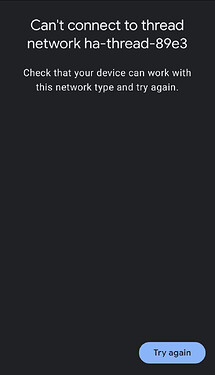

So I’m trying to add the new Bilresa and Timmerflotte matter stuff from Ikea, but I’m absolutely stuck. My setup is an old Conbee II reflashed for thread. Then home assistant OS as VM in Proxmox and the main router as OPNsense virtualized on the same Proxmox box.
I get this far into adding one of them and the companion app shows this while the OTBR addon logs display this:
00:48:39.791 [W] P-RadioSpinel-: Error processing result: NoBufs
00:48:39.791 [W] P-RadioSpinel-: Error waiting response: NoBufs
00:48:45.870 [W] P-RadioSpinel-: Error processing result: NoBufs
00:48:45.870 [W] P-RadioSpinel-: Error waiting response: NoBufs
00:48:51.429 [W] P-RadioSpinel-: Error processing result: NoBufs
00:48:51.429 [W] P-RadioSpinel-: Error waiting response: NoBufs
I can add devices that are matter over wifi. So at least the matter part should work. Also I’ve tried to do the commisioning on the same wifi, too as to not have inter-vlan routing during it. I can ping home assistant’s ipv6 address using my android too. Also the zeroconf tab shows the correct ipv6 address for both _meshcop._udp.local. and _matter._tcp.local. Also I’ve synced the thread keys multiple times.
Only thing i have left the problem could be is Proxmox fucking up the ipv6 packets somehow, the old Conbee II is just ass for some reason or I’ve set up something in home assistant wrong.
Any help would be appreciated :sweat_smile:
