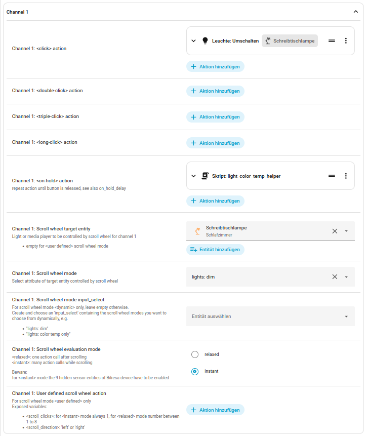

A typical example for a light may look like this:
  • toggle light “Schreibtischlampe” on click
  • use scroll-wheel to dim up/down light “Schreibtischlampe” (you can change dim step size and min brightness as well)
  • on-hold calls repeatedly helper script “light_color_temp_helper” to change color temperature of light “Schreibtischlampe”

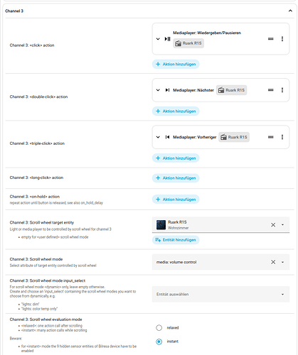

A typical example for a media player may look like this:
  • start/pause player on click
  • double-click jumps to next title
  • triple-click jumps to previous title
  • use scroll-wheel to volume up/down (you can change volume step size and max volume as well)

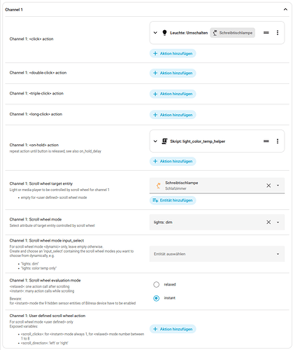

When you add a second Bilresa device it will get same device name and therefore the button entities for the second device will get a suffix like “_2”.
To fix this issue start with giving each Bilresa device a unique name:
and then fix the entity names:
Then you should see entity names like this:
event.bilresa2_taste_1, event.bilresa2_taste_2, …
Unfortunately you have to duplicate an existing automation after renaming and delete the old automation afterwards.
Thanks so much!!
