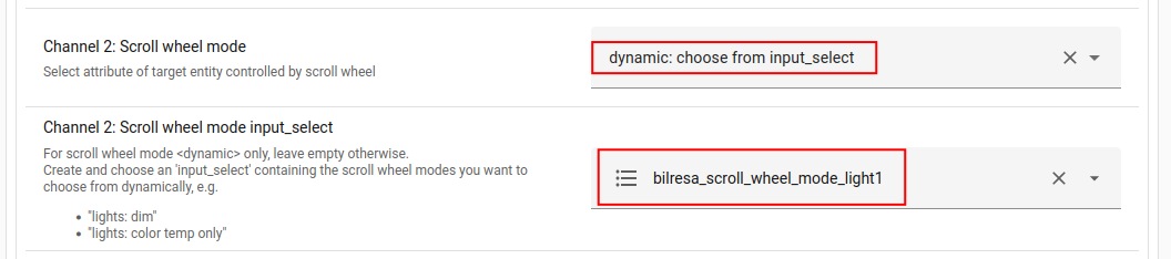

I added direct support for the input_select-helper to Version: 2026-02-07 now, see
with input_select-helper
as toggle logic for the input_select I would suggest the following snippet, e.g. in double-click:
action: input_select.select_next
metadata: {}
  entity_id: input_select.bilresa_scroll_wheel_mode_light1
  cycle: true
Love your blueprint!

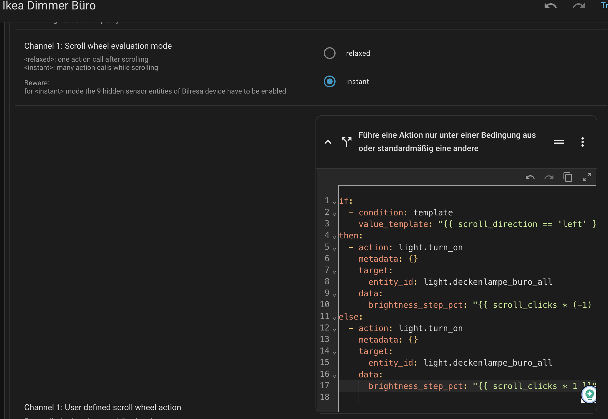

thank you for the amazing blueprint! It works very well for me for color temperature change and volume control. However, I cannot get the scroll wheel to dim or brighten my light. I check everything in here multiple times and I cannot find a mistake. I was about to give the user-defined scroll wheel mode a shot, but the settings look different in my HA version, so I got stuck… Any chance you could help me with that? Thank you!
What I can see from the screenshot looks fine on first glance. Could be that brightness_step_pct needs to be above some threshold, so please try to multiply by 10.
Is the scroll wheel triggering at all on the used channel? Maybe the problem is not about brightness but about the channel, see discussion about that in some previous comments.
Always a good idea: check the traces of your automation if you got some error messages.
