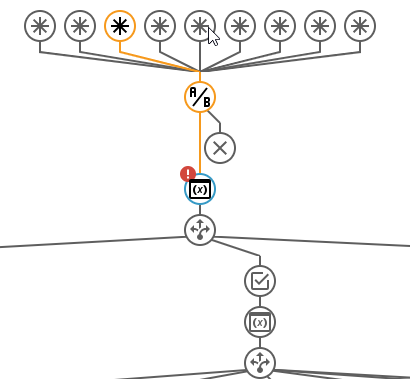

Recently the hold state returns an error:
Define variables m_1, m_2, m_3, s_1, s_2, s_3, l_1, l_2, l_3, tr_1, tr_2, tr_3, action_kanal_id, event_attr, ticks, action_event_type, curr_mode, base_sens, step_val, transition_ms, transition_s, curr_target_obj, curr_target_list, and curr_target
Executed: August 3, 2026 at 09:19:58
Error: ValueError: Template error: int got invalid input 'None' when rendering template '{{ event_attr.get('totalNumberOfPressesCounted') | default(1) | int }}' but no default was specified
What am I doing wrong and what other information would you need form me to help looking into this?

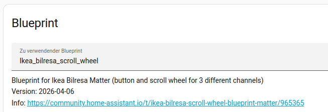

you are using a different blueprint … the screenshot and these variable names don’t fit to my blueprint
my would look like this:
Sorry, I didn’t notice this was the wrong thread

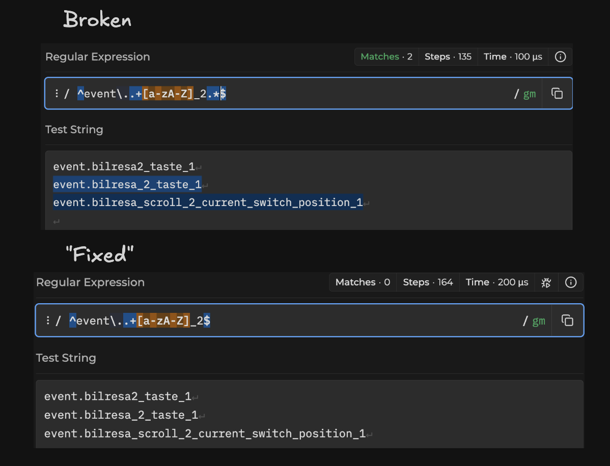

Hey. Thanks for making this. Really excited to use the Bilresa for things around the home. I ran into some issues using the scroll bar. I’m not sure if it’s already been addressed, but I (well, a coding agent) had to tune up the regexp’s to match the entity ID suffixes more reliably. WDYT?
Regex bug in trigger_variables — _N.*$ matches too broadly
The 15 regex_findall patterns use _N.*$ (e.g. ^event\..+[a-zA-Z]_1.*$). The .* before $ allows the regex to match _1 anywhere in the entity_id, not just at the end. For example, event.ikea_scroll_wheel_1_button_9 contains _1 inside wheel_1 — so _1.*$ matches all 9 event entities. Every trigger_variable resolves to a concatenated string of entity IDs, and no state_changed event ever matches.
Fix: change _N.*$ → _N$ in all 15 patterns. After the fix each pattern matches exactly one entity (e.g. _1$ → only event.xxx_button_1).
Before:
regex_findall(find='^event\..+[a-zA-Z]_1.*$')
After:
regex_findall(find='^event\..+[a-zA-Z]_1$')
