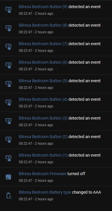

I’m using the blueprint “IKEA Bilresa – Unified 3-Layer Controller” as it was the first I found in English. I’m having issues with the automation triggering randomly and turning on the lights in the middle of the night. It seems the remote reconnects and sends the events below, which trigger the automation. Is this handled better in a different blueprint?

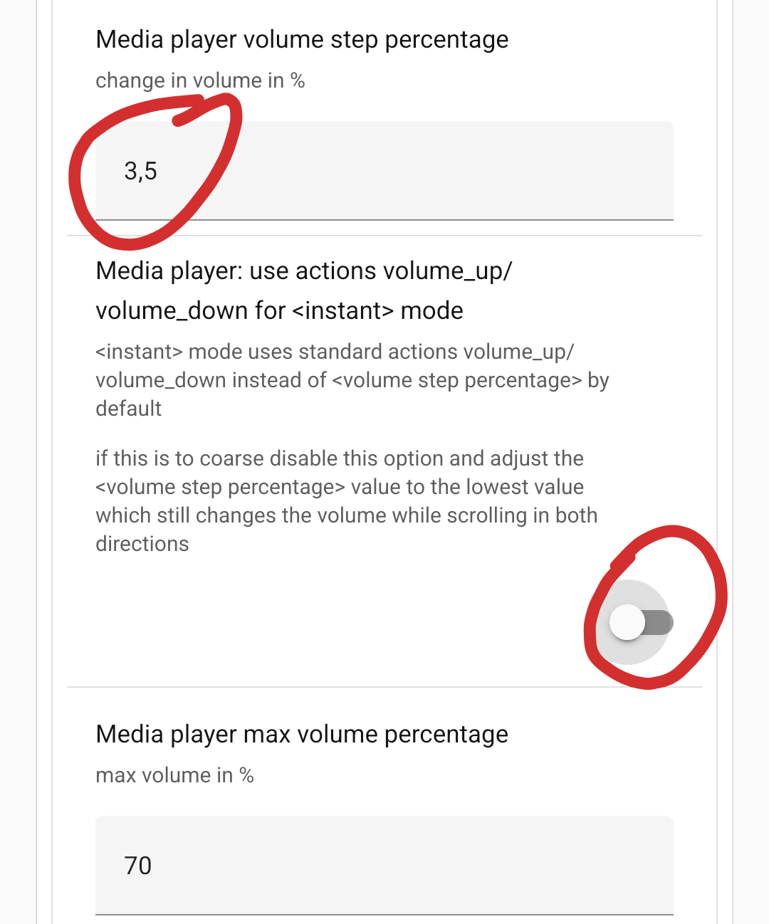

@rnsalinero , @tyxcho an update is available letting you choose to use volume step percentage for instant mode as well
Thank you very much!!!

Does anyone have a solution for the volume control on my Amazon Echo?
I currently have the volume control set to Instant Mode, which works with Stepup. Unfortunately, the Echo only jumps in 10% increments, which is too much for the button to respond to.

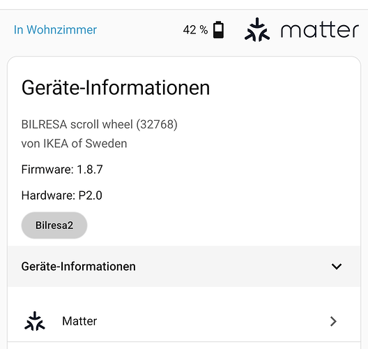

For some reason my bilresa won’t show up when I try to select a device. Anyone that knows of a fix?
Did you pair your device with Matter over Thread?
What do you see in the device dialog, should be similar to
did you try different settings here already?
