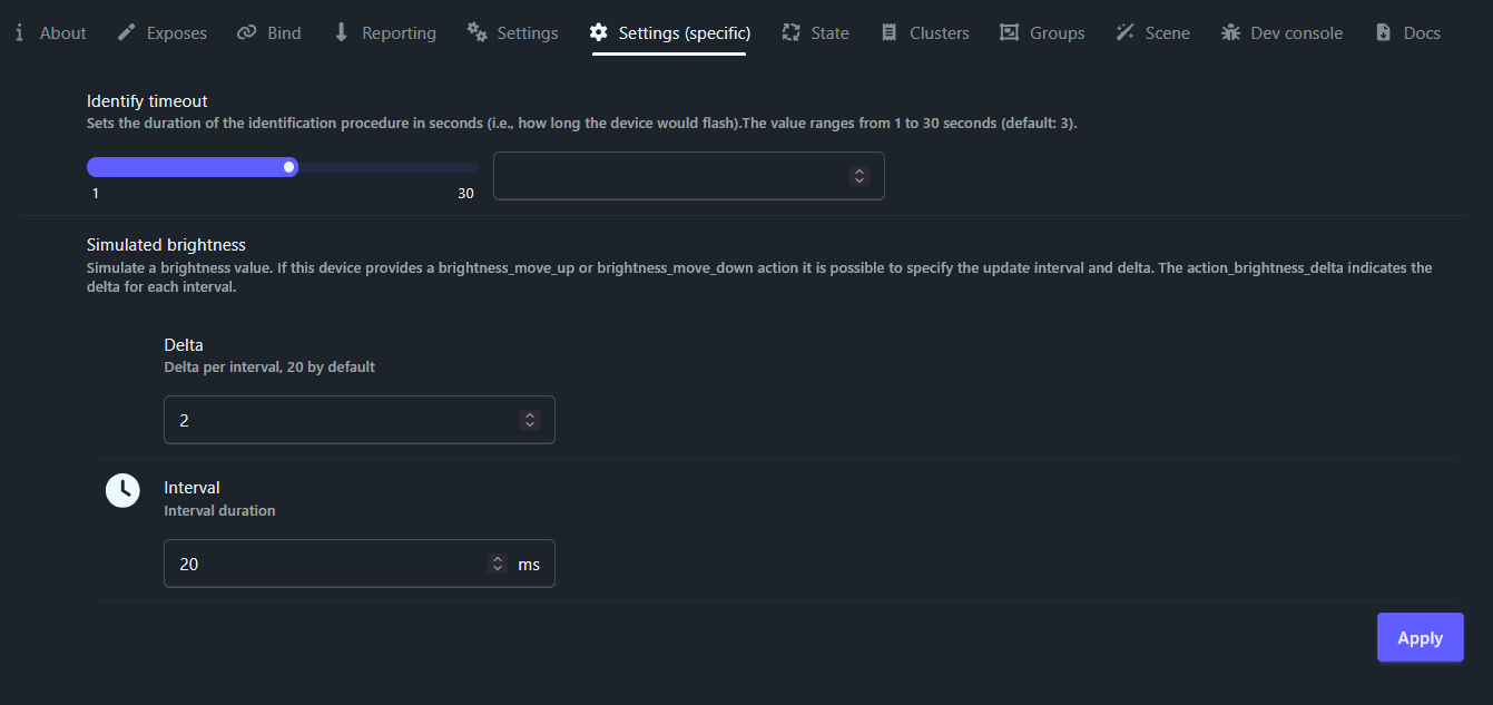

For Fine Tuning: If you want to adjust how “fast” or responsive the physical wheel feels, go to Zigbee2MQTT → Your Device → Settings (Specific). You can adjust the Action Interval and Delta values there to fine-tune the scroll behavior to your liking.

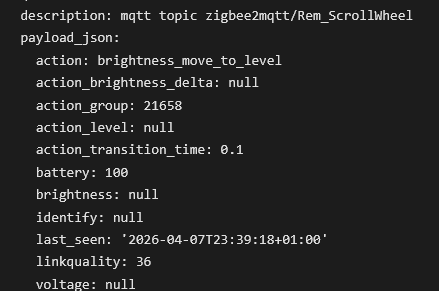

This is the payload when scrolling the wheel
    "action": "brightness_move_to_level",
    "action_group": 21658,
    "action_level": null,
    "action_transition_time": 0.1,
    "battery": 94,
    "identify": null,
    "linkquality": 176,
    "voltage": null
in zigbee2mqtt do you see simulated brightness under the device settings(specific)
I didn't have these earlier so I have added them now and it works better. But now after testing this I have another issue. I cannot get the full brightness range to work. If I set the light at a low setting, say below 130, I can then go maybe between 60 and 180 brightness. I can't utilize the full 0-255 range.
Hi i am not fully sure how to explain that behaviour, whats your simulated brightness interval set at? The automation does not really care what the value is between 0 and 255 as it just needs to know if your increasing or decreasing the value(wheel direction) if yoiu get to 255 simulated brightness from the payload and you continue to scroll clockwise the output to the device(LIGHT ETC) is to increase by the step value input. So if you reach 255 for example and the light is not at full brightness it should not matter we check the last value and if its the same or greater then we continue in that same direction and in turn increasing the brightness. The opposite is the case for 0 value continue to decrease the output.
If you can do a quick test? Keep scrolling the wheel clockwise and ensure you see 255 in the payload, now manually go to your light and drop it down to near 0 %. now continue scrolling clockwise what does the light do at this point?
