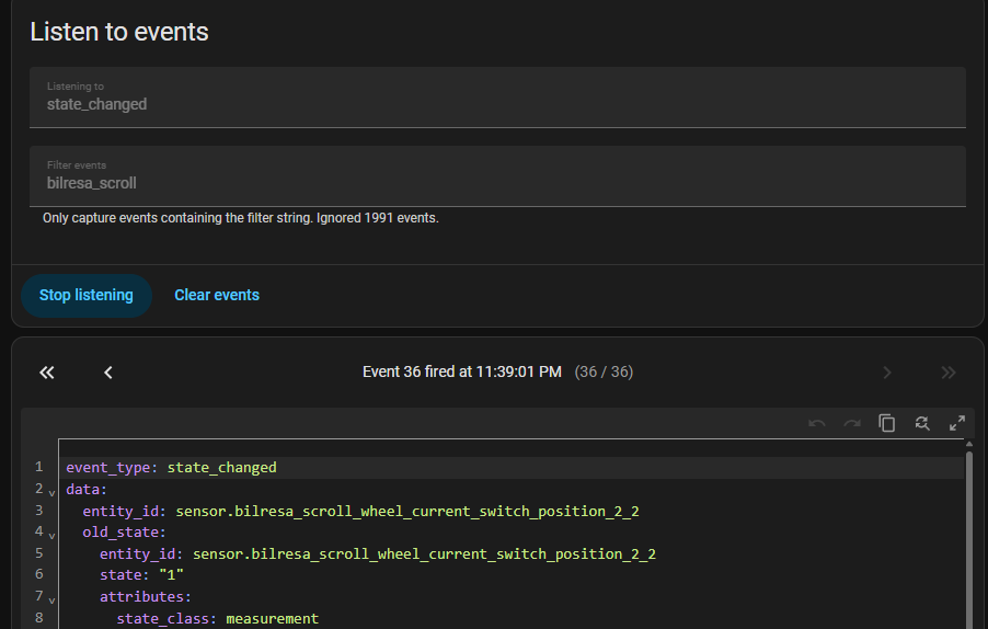

When I do the same at home with that setup, if I click it too fast more than 3 - 4 times, it "freezes" and doesnt react to the channel switch button anymore until I stop touching it for like 5 seconds... The scroll behaviour is also not very nice, with it kind of freezing / jumping between increasing / decreasing the bulb...
Are the two units bad? should I try diffrent batteries? do I need the ikea hub?
I tried looking at the events that come in, to try and see if the automations are bad, but it seems that the events match what im seeing, sometimes they stop coming in, and I need to be very slow on the wheel to actually see the states toggle correctly between the 1 and 0 on each switch
