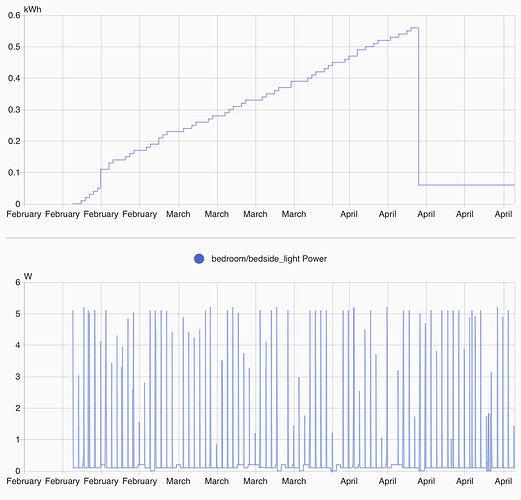

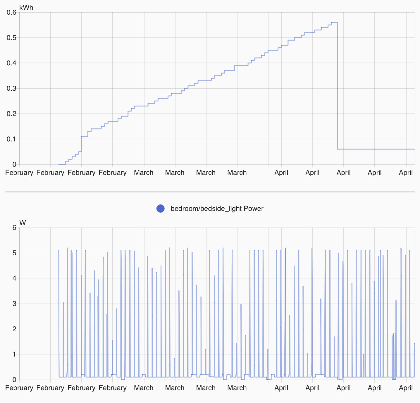

I have a few Ikea INSPELNINGs (UK version) and while they’re all behaving correctly in terms of switching and instantaneous power readings, none of them are reporting cumulative energy correctly. They’ve all stuck at a value for weeks (some zero, some slightly above zero). When just installed, one of them was incrementing in a plausible way, but has since reset to near-zero:

I have searched and while there are people reporting problems (on older firmware) with the instantaneous value, but I’ve not seen mention of this issue with the cumulative value. I guess it’s probably possible to have HA compute the sum of the instantaneous values (beyond my yaml-ing at this stage though). It would be nice if the device just reported correctly in the first place.
