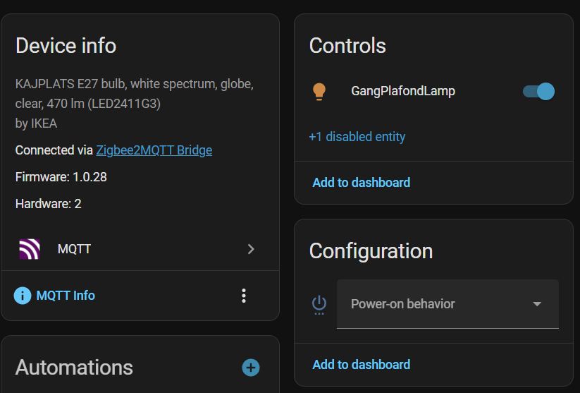

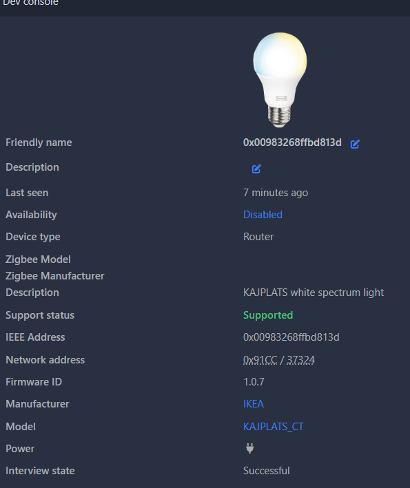

i can confirm i got it working (a KAJPLATS E27 bulb, white spectrum, globe, clear, 470 lm (LED2411G3)) with 15x poweroff/on with following setup:
- Zigbee2MQTT docker latest version (i have HA also in docker
) - SMLIGHT SLZB-06Mg24 over ethernet.
In earlier attempts i tried the 6x power-cycle. But after 15x It connected to Z2M just by pushing the “Join Allow” button.
The bulb seems fully supported now… ![]()

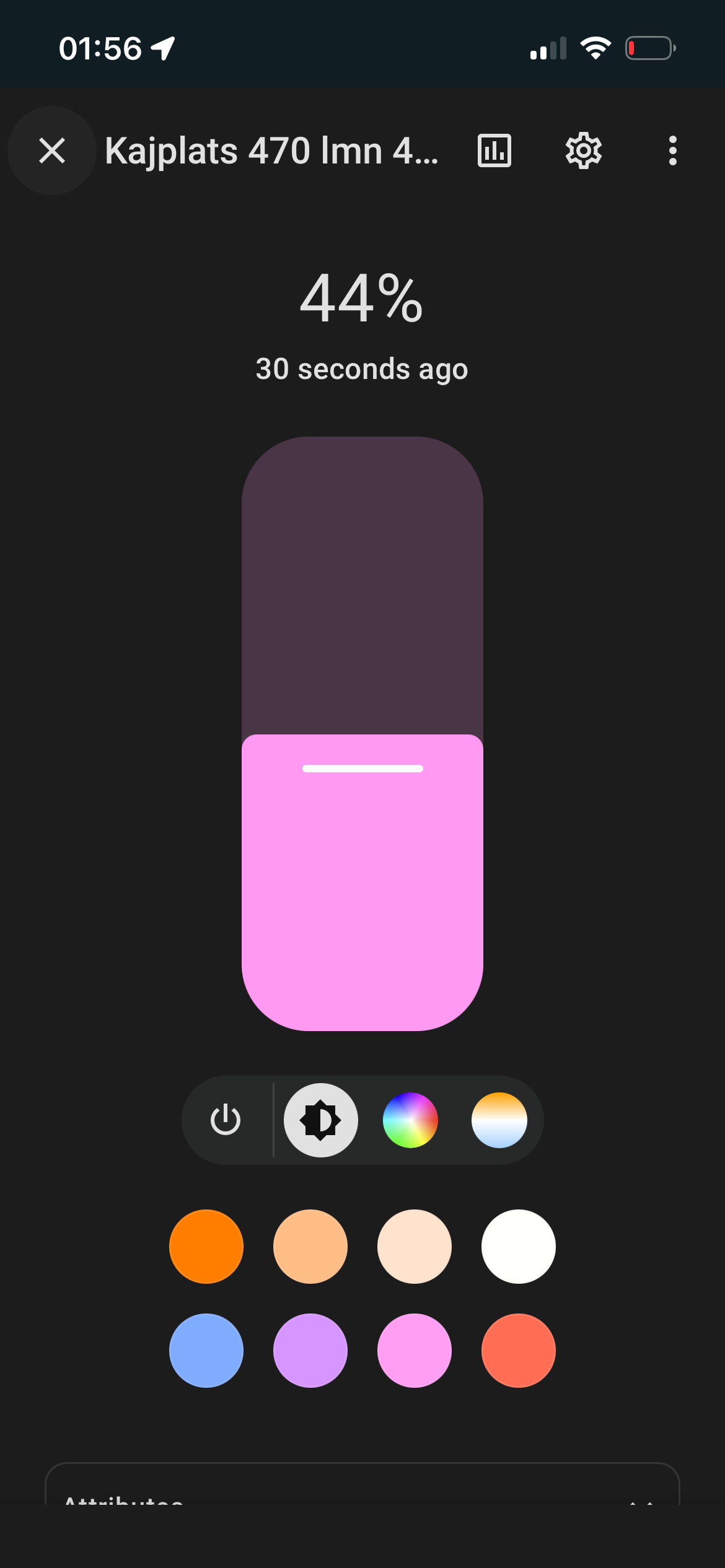

The only problem I have with the connected ones is that the red is totally off. It is Pink and not Red. Not sure if it’s the bulbs or because I connected them via Zigbee. Anyone got the same problem?
