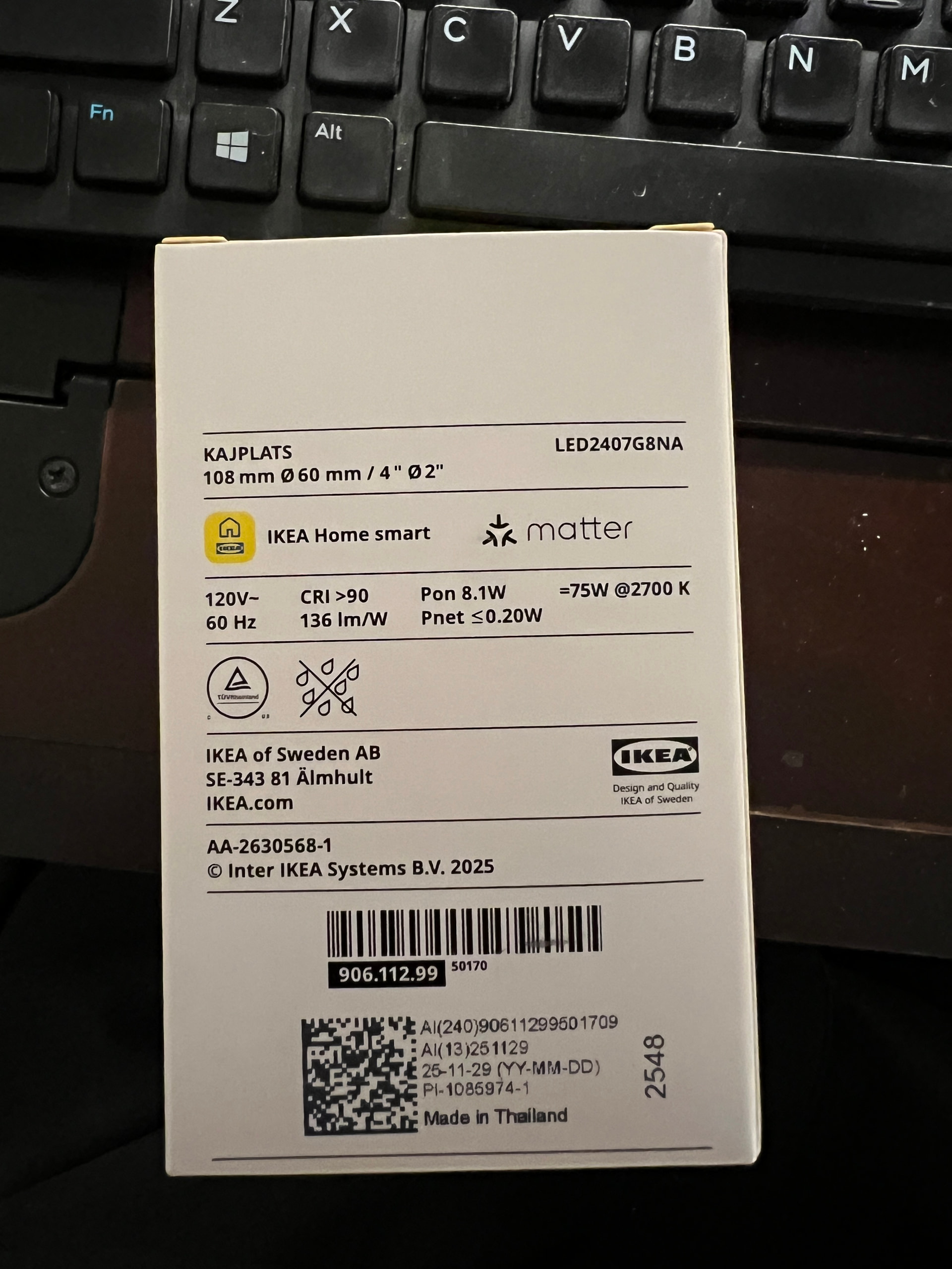

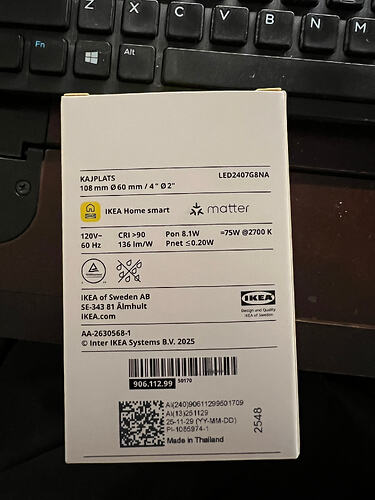

I just got a Kajplats E12 800 lumen light that is labeled as Matter compatible but doesn’t mention Zigbee anywhere. I don’t use matter and am very happy with Zigbee and Z2M, so got this in hopes that it could be converted to Zigbee mode.
I am happy to say it was super easy to get it into zigbee mode. It helped to have the bulb plugged into a lamp that has an easy on/off switch.
Starting with the bulb off, first I confirmed I could get the bulb to “reset.” I turned it on, waited a split second for the bulb to actually illuminate (important! it is possible to switch the power on/off too fast, you have to actually let the bulb turn on), and then turned it off and then back on x6. The final state of the switch has to be “on” or else the bulb doesn’t have any power to actually do anything. This may seem obvious to most but the whole multiple cycles thing confuses a lot of people. The bulb will then flash a couple times to indicate it has reset.
If you can’t get this step to happen, you need to work on your on/off technique until you can do it reliably before moving on!
Then I activated my “permit join” using a nearby Zigbee device on my network in Z2M
I then did the same thing but did 12x on cycles. The bulb color changed to a high temp bluish tone and pulsed a couple times before joining my zigbee network. I can immediately change lots of settings in it. Working great so far.
Going to use this with a cheap plastic Ikea lamp housing (Lampan) to make a wakeup lamp for my toddler.

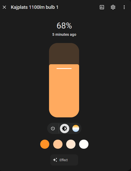

I was able to get a Kajplats E27 470 lm working in ZHA by power cycling 12 times. Unfortunately the warm temps are a disgusting greenish yellow, so I’m looking elsewhere for bulbs now.
People usually say that "IKEA RGB bulbs don't have the green tint. Buy RGB models, even if you don't want colors, to have nicer whites"
Went the to Ikea store in Ottawa today, bought a Kajplats bulb, and I too was successful in pairing it using Z2M. Looks like I needed to reset it first (power-cycling 6 times), but the light did not blink or otherwise communicate its 'reset state.' I then power-cycled it 12 times, with a 1s pause in between states (on for 1 second, off for 1 second, etc) and it paired after that in Zigbee mode.
So happy about that.
They’re cheap enough that I might give an RGB model a try. I’ll report back if the result is better. Thanks.
