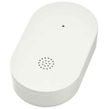

💧 IKEA KLIPPBOK *Matter over Thread* Leak Detector (E2493)
IKEA KLIPPBOK Matter Leak Detector - Blueprint
This blueprint provides leak detection and alerts for selected IKEA KLIPPBOK Matter Leak Detectorit may work with other devices, this is designed to work with KLIPPBOK and matter. I have it working fine in combination with some Tuya water sensors, YMMV
