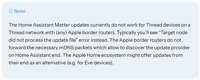

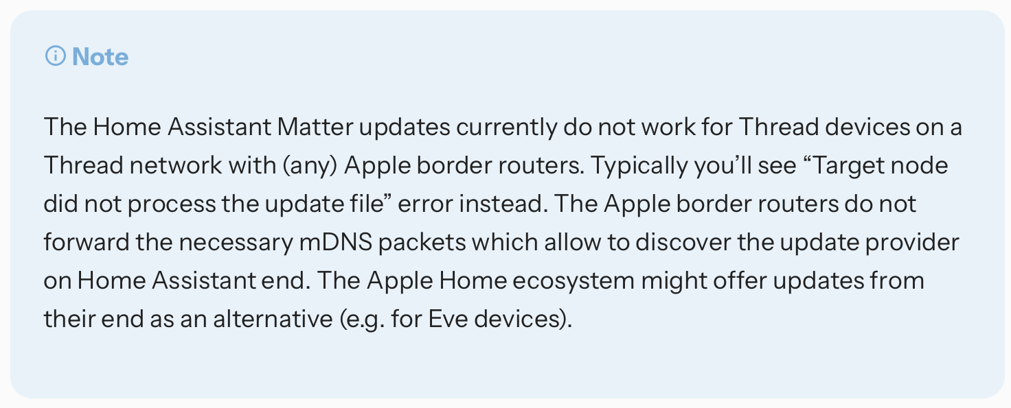

Updates don’t work while Apple border routers are switched on:
:man_shrugging:
All I know is that his updates worked.

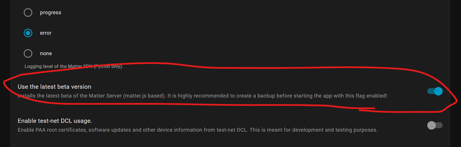

I just updated to the 8.2.0 matter server, switched on the beta, so that the new matter.js server is being used - and I was able to install some updates for my Matter over Thread devices for (I think?) the first time.
Let’s hope I didn’t completely bork my system by moving over too soon, but it seems promising that the new matter server will likely work!
I tried the beta matter server (it’s set in the configuration settings under the matter server in the add-ons section, not the matter thing in integrations) and indeed, the update seemed to go fine, got an installation bar graph and the unit did a reset (be patient, takes a few minutes) and it seems to be updated and working fine. While I don’t have a lot of matter devices, in brief testing everything else seems to be working.
Old news and no longer true as of 2 or 3 iOS versions in the past. I update 30 or so inovelli Matter over thread multiple times via Home assistant and just recently several Ikea with only apple TBR in the thread network.

Just to let you know, the new Matter Server (GitHub - matter-js/matterjs-server: Matter server based on Matter.js) works really well in a container environment.
You can just replace the container with the same configuration base and that’ll get the job done.
This fixed the update problem. Just so you’re aware, the web API has been updated.

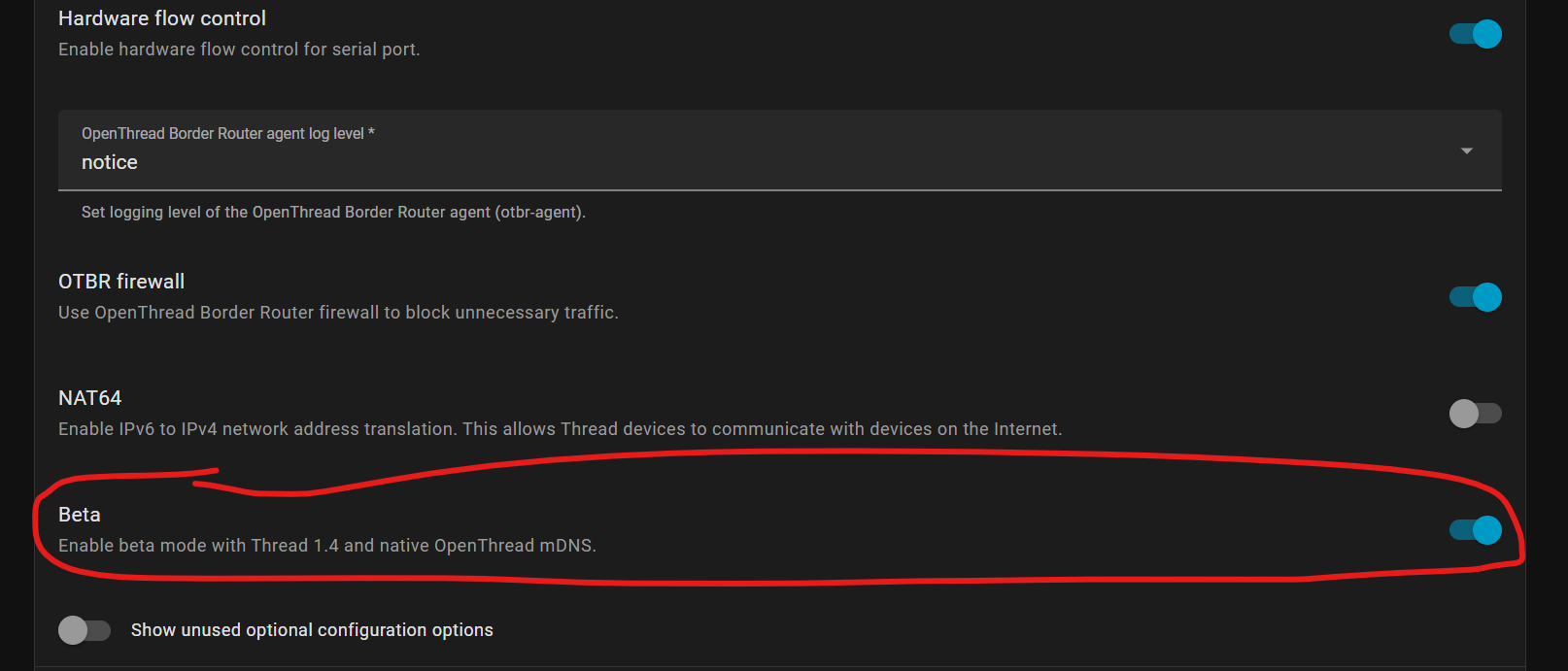

I had an IKEA ALPSTUGA firmware update when using beta:
Beware if you change these settings as you might need to reconnect all your devices.
