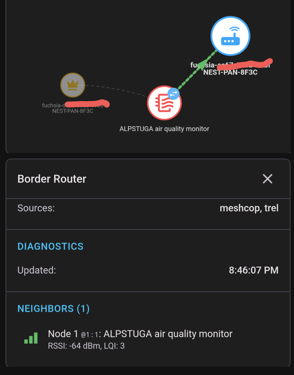

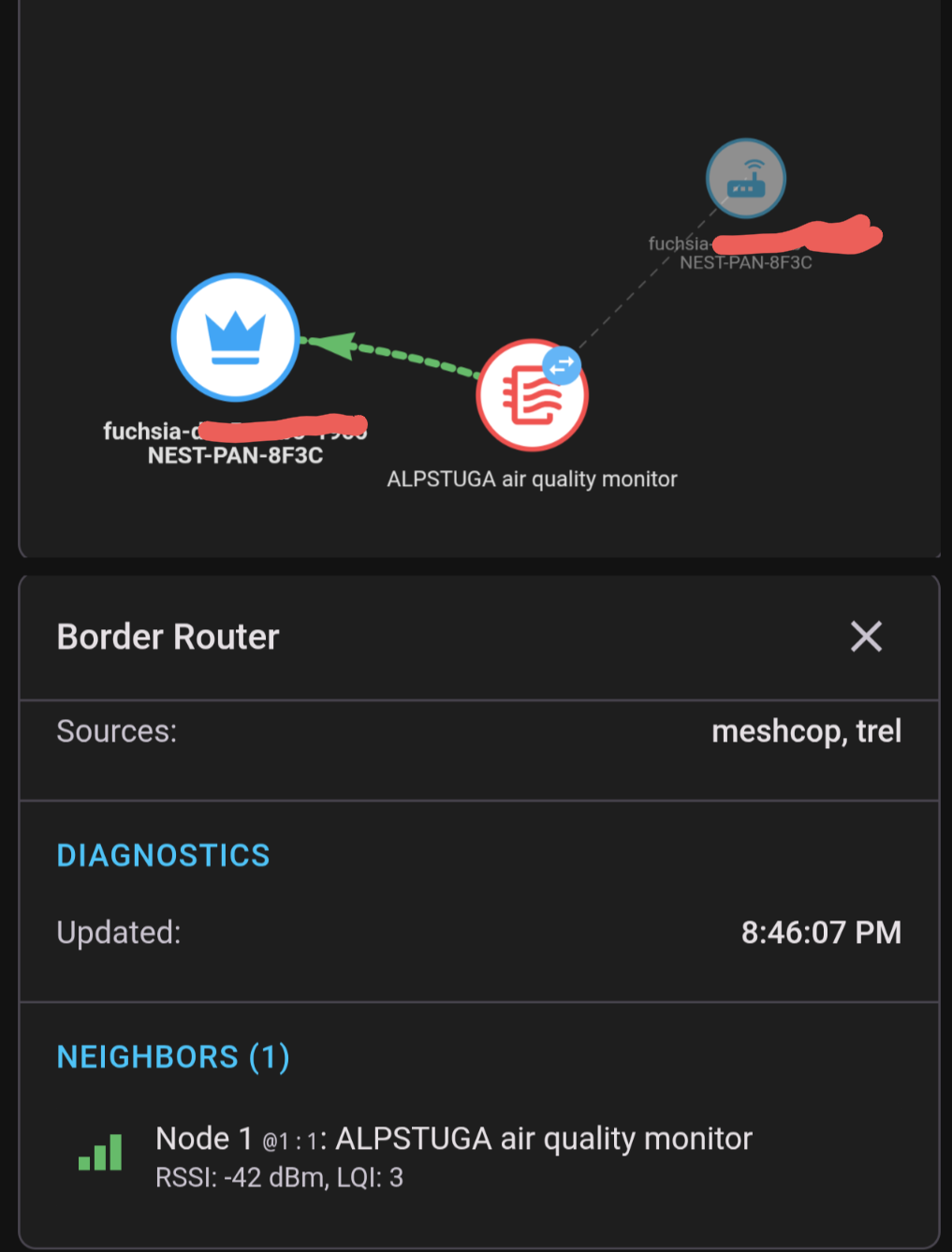

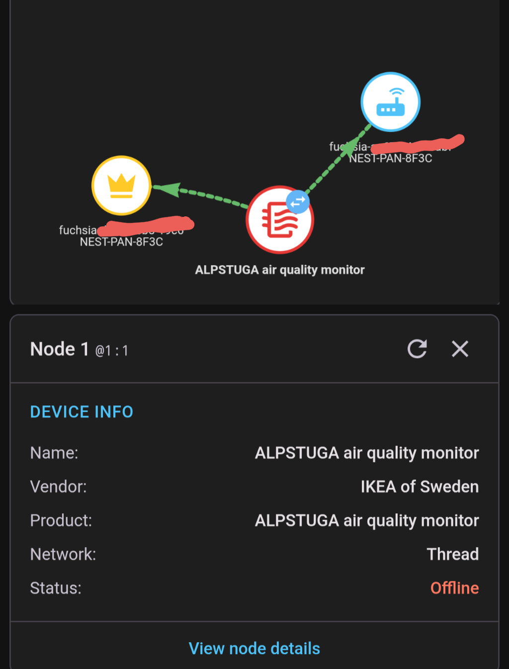

I have this exact issue. I’m not using my Skyconnect in Thread mode right now. But I’m planning on removing the 3 things on that Zigbee setup to free up some spectrum and see if that helps.
However, my issue is even more bizarre. I’m using my Google Nest Hubs as routers, and was able to add one IKEA device after months of occasionally trying. But it keeps going offline. According to Matter Server, both routers can see it with good signal, but neither Google Home nor HA show it online.
