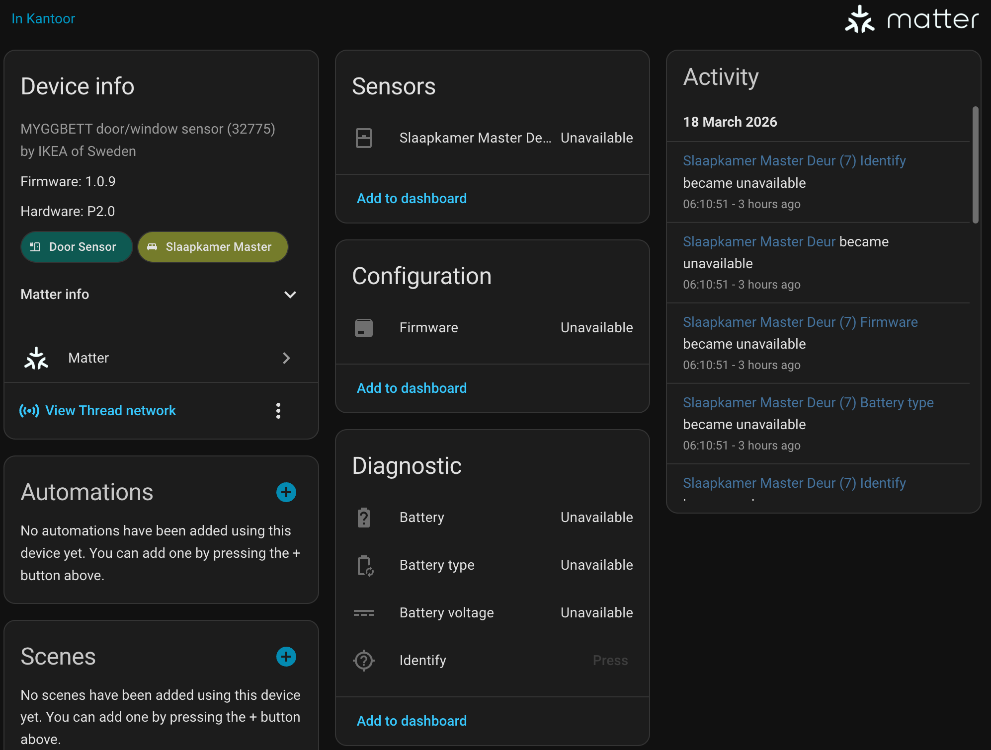

I’ve a number of MYGGBETT sensors in my house, there is one location where I’ve a sensor which loses the connection with Home Assistant. I’ve swapped two sensors and the problem doesn’t move, it stays at the same location, the new placed sensor also loses connection.
And what is strange, 40 cm to the right there is another same type sensor which is NOT losing the connection to HA. Really strange.
Any suggestions on how to address this? I’ve read that Ikea is working on this and they acknowledged they have connection challenges.
